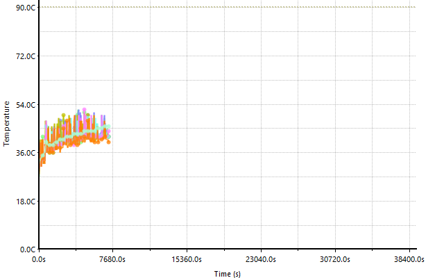

          I don't think I understand the "200 pixels width" and scaling. I changed the samples to every 60 seconds, and zoomed the graph to the maximum and ran the test for 2 hours... you get what is below, which looks like it would show 10 hours.

            Currently the test certificate will display the temperature graph as it's drawn in BurnInTest (so if you zoom out that what's saved).
            In the next build we've made a change so the temperate graph is redrawn at the end of the test to show all the collected samples and this will be exported to the certificate.
            • #7
              That sounds perfect, thanks!
