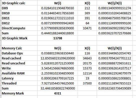

    For reasons not worth going into, I have produced a spreadsheet using the numbers shown on this page (https://www.passmark.com/forum/perfo...and-disk-mark=) to recreate Performance Test Results, but I can't get the numbers from running the test to match up.
    I can get very close to the overall rating using the individual ratings for the 5 categories, and my calcs for 2D graphics and DiskMark are also very close, but the memory, CPU, and 3D Graphics are way off.
    For example, see the calcs for CPU Mark below. Running Performance Test gave 17111 for this compared to 18290 by my calcs.
    Any ideas?

      Thanks David, it's build 1025. CPU is i7 8700 @4.8GHz, but I don't think that's the issue. Did you look at my attachment? By those calcs, the CPU Mark is 18290, but the score given in PT was 17111.
      The CPU Mark was just an example. As you can see from my original post, I can't match the memory or 3D Graphics result either. Do my calcs in the attachment look correct?

          Thanks Richard, that explains that one. Now, what about memory and 3D graphics. Here are my calcs in the attachment. PT gave Memory Mark as 3442 and 3D Graphics as 15400. Mine as you can see are 4311 and 13798 respectively. Click image for larger version

            Be aware that for RAM Latency, lower is better. The inverse of all the others, where higher is better.
            • #7
              Thanks David, but I’m not sure that helps. My calcs shown in the attachment do not match those given in Performance Test results and I can’t see where I might have gone wrong.
