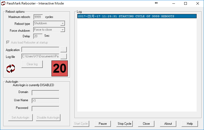

    In order to test the ON/OFF stability of DUT, we use the BurnInTest rebooter program to test power on/off behavior.
    The rebooter setting is as pic1 shows and we set 9999 cycles.
    Under test processing, we found an error at 313 cycle.
    1. The system can enter WIN 10 OS successfully.
    2. But the rebooter program seems not auto load at startup only on at 313 cycle.
    After next cycle, the rebooter program can auto load.
    We test for several days, and found the error cycle is randomly, not fix.
    Our question is: why does the rebooter program not auto load at startup randomly?
    Did we use the wrong setting for rebooter? Or have you
    Thanks for your feedback.

    Are you using the latest release of Rebooter, V1.3 Build 1007?
    We aren't aware of any problem that would stop Windows launching the application randomly. (and the Windows startup process is out of our control).
