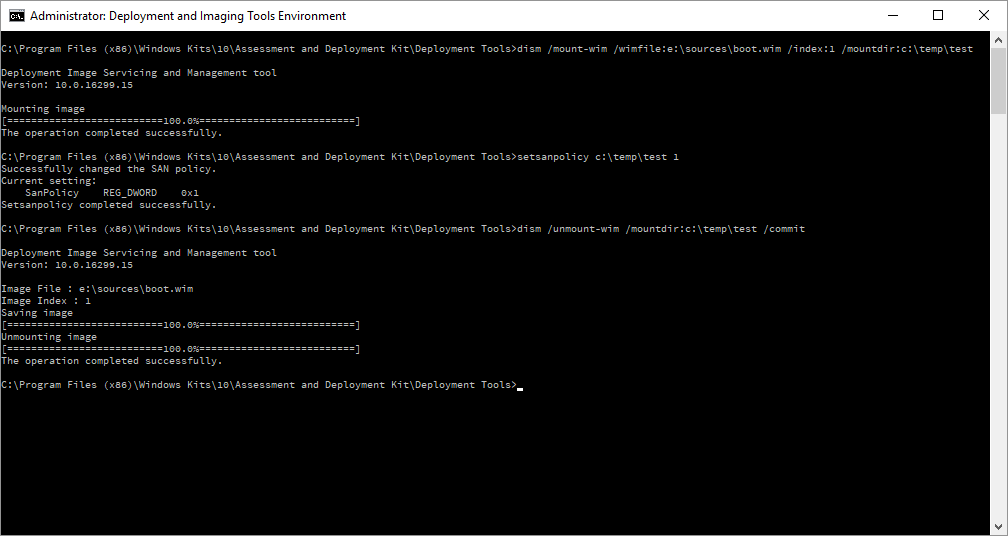

                          Looking over the code, it seems I misspoke...due to a bug. WinPEBuilder does call Setsanpolicy on the WinPE image, but it should of only be called when the program selected is our digital forensics application, OSForensics. The bug was applying this policy to all images.
                          Two possible solutions:
                          1. This bug is corrected in WinPEBuilder V1.2.102. You can create your image anew.
                          2. If you are comfortable with the command line and don't want to build your image again. You can modified your existing images.
                          • Open the "Deployment and Imaging Tools Environment" with administrator privileges.
                          • Mount the existing image (e.g. "dism /mount-wim /wimfile:e:\sources\boot.wim /index:1 /mountdir:c:\temp\mount", mount directory should already be created)
                          • Set the SAN policy (e.g. "setsanpolicy c:\temp\mount 1", 1 is online, 2 is shared offline, 3 is offline)
                          • Commit and unmount the image to save. (e.g. "dism /unmount-wim /mountdir:c:\temp\mount /commit")

                            Goodmorning PassmarK
                            with the last suggestion the program works correctly, formatting the disk and does not protect it from writing.
                            There remain errors that tell me that there are no media inserted (see the second picture of my first post). I have found that the problem is determined by the "Automatically select all fixed disk .." flag.
                            He seems to want to test volumes and ninth discs. As a result, it creates the error. Disabling the flag and choosing what to test the program correctly tests the disk.
