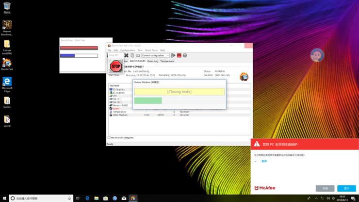

    Brun in test Sound Fail, No operations reported in timeout period
    Platform: Intel Coffee Lake
    OS: Windows 10 RS4 17134
    Burn in version: v8.1 Pro 1025
    Every cycle: 8-12hrs
    Error as below:
    Sound, No operations reported in timeout period
    And burn in test crash when test finish.
    Could you help check the log files?
    Thank you very much.

      Hello David
      sound fail like sound card device driver crashed, sound card device vendor is Realtek, could you receive some help from Realtek?
      Another question, could you help check why Burn in tool stop and hang up at the end of test period ?
      Thank you.
