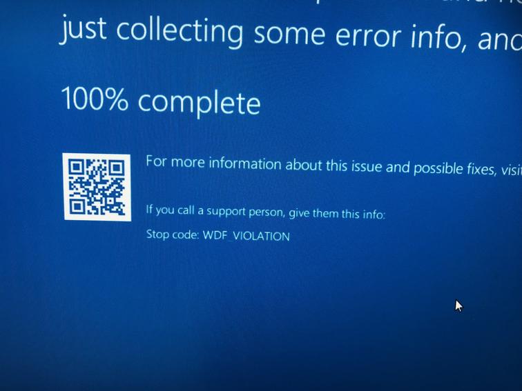

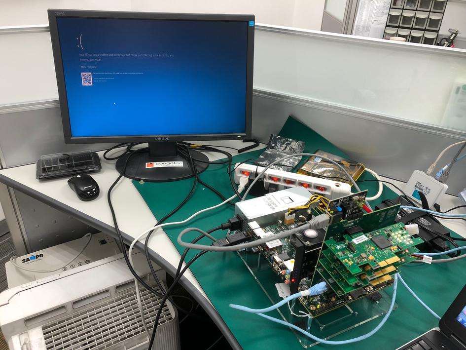

    We are using Burn In v8.1 and PCIE test cards to stress the PCIE interface.
    The interposer card is the EVM of DIODES PI7C9X2G606PR (https://www.diodes.com/products/conn.../PI7C9X2G606PR)
    After running for 5 hours, Windows 10 64bits happened BSOD (refer to attached pictures)
    Does anyone have ideas about this behavior?
    Thanks,
    Mark.
    The version of BurnInTest you are using is old. Can you try with V9.
    When were these cards purchased? What firmware release are you using?
    What device driver release are you using?
    Is the problem reproducible? If yes, does it always happen after 5 hours?
    Did you get a crash dump from the BSOD? Your photo indicated that it was a driver fault. But didn't indicate which driver.

                      - Currently we didn't use the extender card. We plug 4 PCIE test cards on motherboard directly.
                      - We can't see BSOD by using 1 card for 12 hours. We didn't test it longer time.
                      - Attached is the mini dump file for your reference.
                      I refer to "https://docs.microsoft.com/en-us/windows-hardware/drivers/debugger/bug-check-0x10d---wdf-violation"
                      It showed "Parameter 1 indicates 0x8. The handle of the DMA transaction object. An operation occurred on a DMA transaction object while it was not in the correct state."
