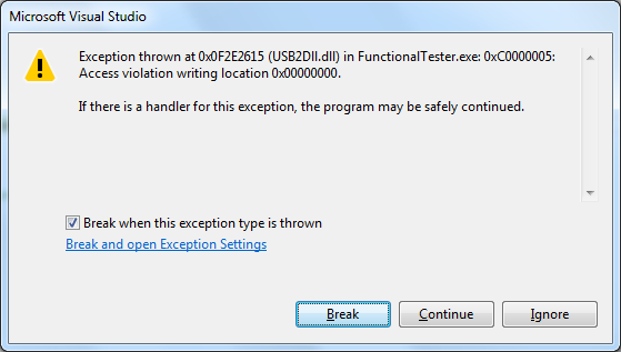

      Thanks for getting back to me, unfortunately the compiler does not like the ref keyword on the call, but the actually exception is the attached image. I get the exception only when the function is called. The GetLoopbackresults works great.
        It looks like one (or all) of the variables being passed in to GetLoopbackresults is NULL (calling USB2GetBenchmarkResults(NULL, ...) would cause this sort of behaviour).
        It may have something to do with the way float values are handled in C# as that is the main difference i can see between USB2GetLoopbackResults and USB2GetBenchmarkResults. Possibly you need to use 'double' in c# rather than float (https://www.codeproject.com/Articles...ng-Simple-Type).

          • Lee
            • Feb 2019
            Tim, you were right had to combine all elements together. Thank you very much!
