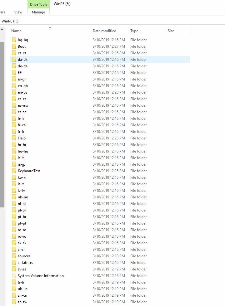

        I have attached an image of my bootable pe file which works great and it tries to run the keyboard test first when I boot off the usb, it simply doesn't know where to find the file and I don't know where it is looking for the file so i don't know where to put it.
        The base WinPE is loaded into RAM and the root OS directory is X:\ drive. Besides the OS drive, there is no easy way to determine which drive letter will be assigned to USB Flash Drive or the other drives installed on the system.
        Can you tell me where to put it or if I should be using the program / files section to add this using your winpebuilder? If I am supposed to be using the program / files section in winpe builder to add this do I need to select folder and what would I populate the destination with?
        You should be able to use the "Add additional files" option in WinPE builder to copy the entire directory of KeyboardTest install. Make note of where you choose the destination folder as that will be the path for the directory in the WinPE image, e.g. if you specify "\Program Files" as the destination, then the files/folder will be located at "X:\Program Files" when in you boot into WinPE.
        If you do not want to recreate the WinPE image again, you can modify the existing image by manually mounting the existing WinPE image, edit the contents, and save/dismount the image. See the link from the last post.
