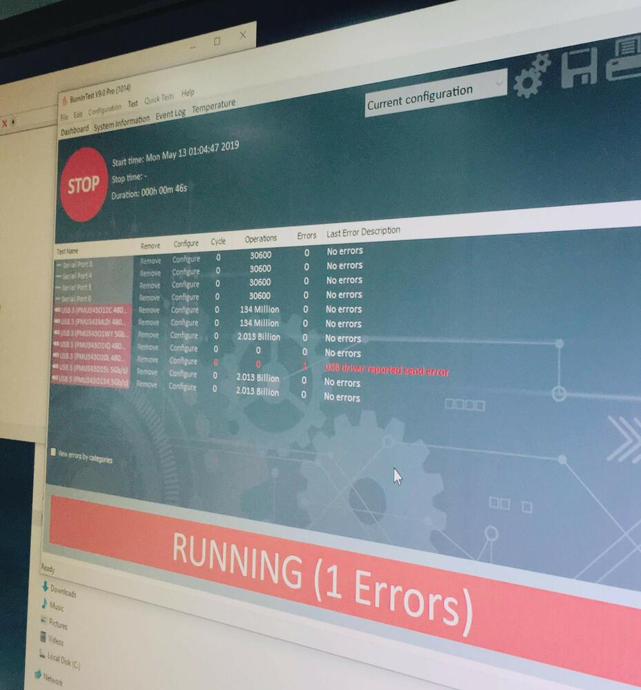

    USB loopback plug test fail
    If we test with 7 USB loopback plugs(4 for 2.0, 3 for 3.0) and 3 com ports (USB to Com port), it will pass. If we test with 7 USB loopback plugs(4 for 2.0, 3 for 3.0) and 4 com ports (USB to Com port), USB loopback plug will fail with USB driver report send error. Since the USB to Com has bulk and interrupt, does this affect the USB test fail?
    Thanks.

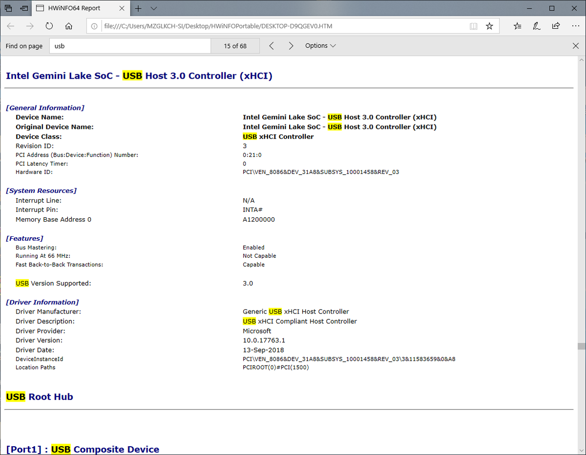

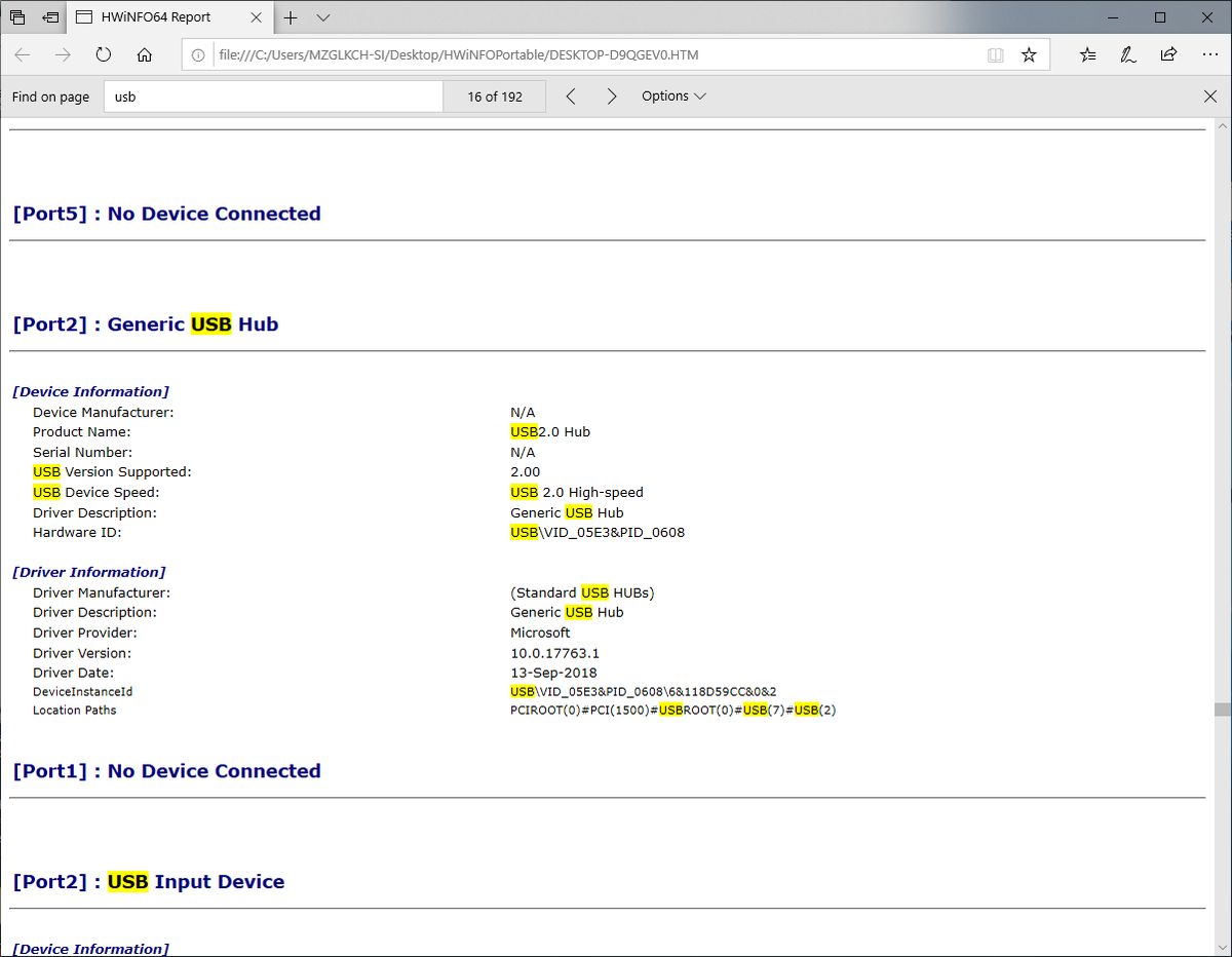

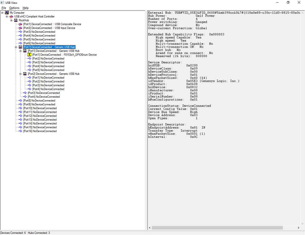

        • a910599
          • May 2019
ID:	44577 Click image for larger version
ID:	44578 Click image for larger version
          This is hub's information. Only attach at Figure 2 hub will fail.
          Thanks.
            You didn't include the system specs, but I assume it is a really low end system.
            I suggest you do the same test with 11 USB devices on a higher powered desktop machine. We suspect it will work fine. In which case that will point to it being a load issue in your hardware or device driver.
