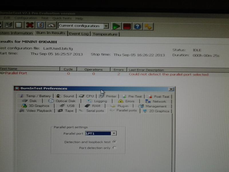

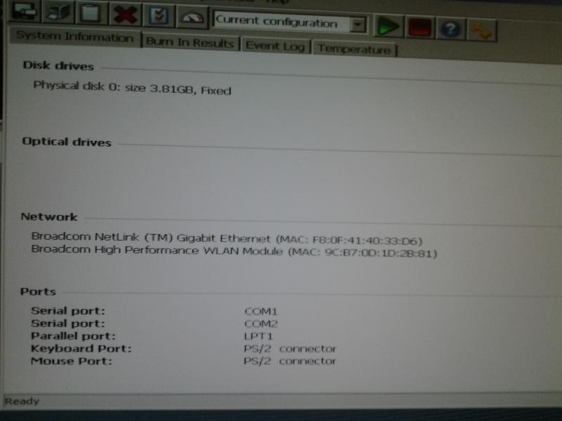

    We have a problem that parallel port not worked.
    The paralllel port is detected and showed in the System Information, and in test perferences, the parallel port showed "LPT1". But when I run the test, it showed “could not detect the parallel port selected” “could not detect the parallel port selected”, do you know what's the problem? Thanks.
ID:	35097Click image for larger version
  • Ian (PassMark)
    • Feb 2004
    • 822
    If you want to test parallel ports on WinPE you need to ensure the parallel port service is started and install the drivers. For example:
    winpeshl.ini
    [LaunchApps]
    %SYSTEMDRIVE%\Windows\System32\wpeinit.exe
    "%SYSTEMDRIVE%\Windows\System32\net", "start parport"
    "%SYSTEMDRIVE%\Windows\devcon.exe", "install x:\windows\inf\msports.inf ACPI\PNP0401"
    "%SYSTEMDRIVE%\Windows\devcon.exe", "restart *PNP0401"
    "%SYSTEMDRIVE%\Program Files\BurnInTest\bit.exe", "-h -x"
    Startnet.cmd
    wpeinit
    net start parport
    devcon install x:\windows\inf\msports.inf ACPI\PNP0401
    devcon restart *PNP0401
    "x:\Program Files\burnintest\bit.exe" –h –x
    *devcon will need to be downloaded from Microsoft and included in the WinPE build in the Windows directory.
    Please see:http://www.passmark.com/ftp/BIT_WinPE.pdf
