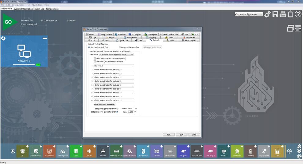

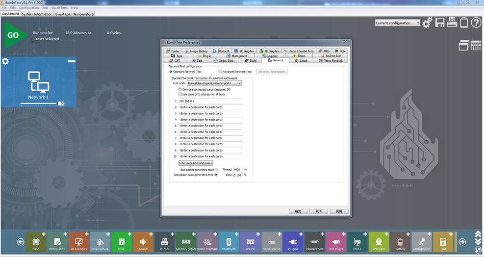

        What test options are you using for the network test? (in the preferences window)
        • nk4qp1530
          • Dec 2019
          • 17

            And is 192.168.0.1 the same machine that is running BurnInTest (I hope not, as that would be a rubbish test) or an external machine on the same network?
            You are using the Standard Network test, which is basically an enhanced Ping test (with an extra data packet). Running it at 100% mean it sends a huge number of pings per second (e.g. 500 per second). Ping uses the ICMP protocol, which doesn't guarantee delivery (unlike TCP/IP). So loosing a few packets over 6 hours isn't that bad. i.e. a few errors doesn't indicate a hardware failure.
