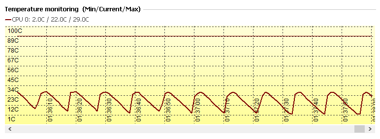

    New build, FX9370, cycles these temperatures. Liquid cooler fans cycle very low to low speed, based on sound. I suspect the CPU is temperature cycling, and would like advice on best way to proceed if this is a correct suspicion.

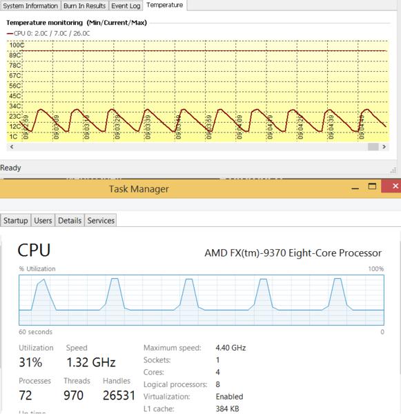

      Maybe I don't understand what to expect. I thought the cpu would ramp up to a high temperature, and remain there to get the best performance. Instead, it is oscillating like a jagged sine wave between the low and high temp.
      The range 2C to 29C is based on the graph produced by the software:

        From the graph you posted it looks like the temperature control on the cooler isn't very good. I would have thought it could run at an intermediate speed to maintain a more constant temperature. Maybe it only had two speeds, fast and slow?

          The BIOS shows a temp of 42C. The CPU must be throttling as you suggest because its frequency varies between about 1.3 and 4 Ghz.
Name:	CPU Cycle.jpg
          Next stop should be a cooler replacement, since it appears the CPU is performing normally... Agree?

              There was a bug in BurnInTest Version 7.1 build 1009 to Version 7.1 build 1012 for this CPUs temperature reporting. Could you please check you are using the latest build, V7.1.1017:
