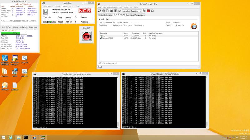

      We have a new finding today. When we use BurnInTest to stress CPU and memory only, but use Winthrax to stress stoarge, the system has been running for over 115 hrs w/o problem. See picture below.

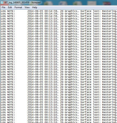

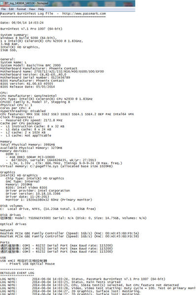

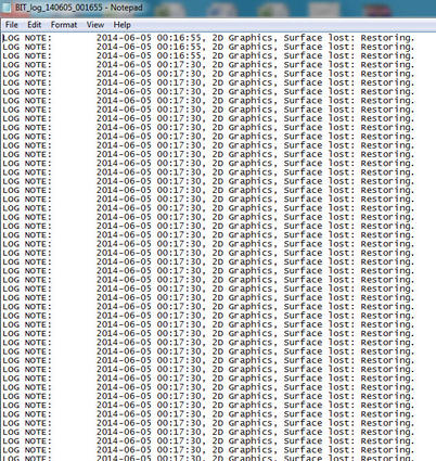

            Following your instruction, we got the log files written to disk. Here's the scenario:
            1. Connect the box PC with a monitor to do the set up and run BurnInTest. Once done, we unplugged the cable.
            2. After running for a couple of hours, we plugged in the cable again to find the BurnInTest shutdown.
            3. We checked the log files and found that once the monitor was unplugged, the system kept getting log note, saying "2D Graphics, Surface lost: Restoring"
            4. The log files, starting from beginning till we reconnect the monitor, take 673MB of capacity.
            3 log files are attached for your reference. Got any clue how this would happen?
            - BIT_log_140604_140324: the first log
            - BIT_log_140605_001459: the second last log
            - BIT_log_140605_001655: the last log (the capacity is relative small)
