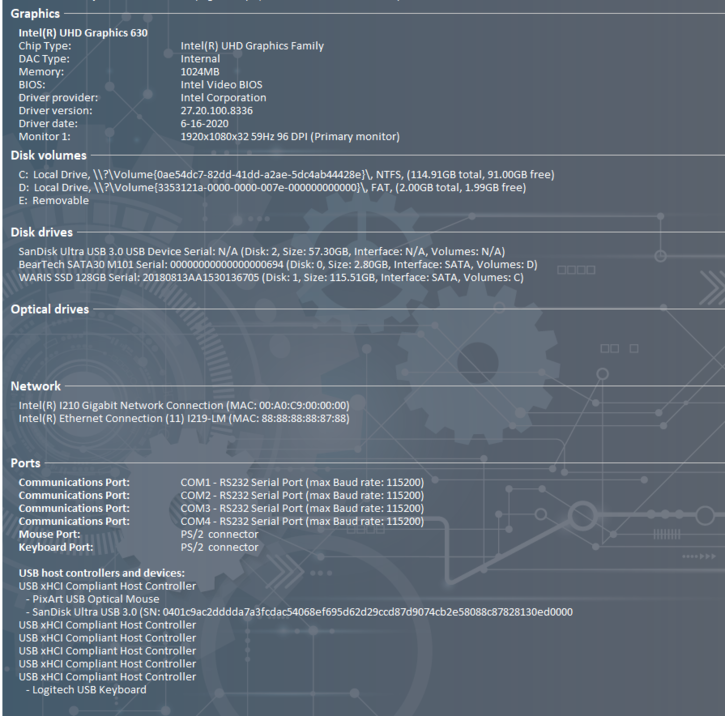

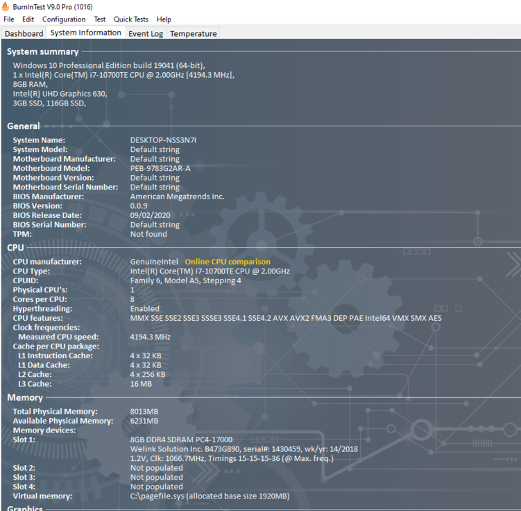

      Your screen shots seem to bear no relationship to the problem you are having? What was the 3D error?
