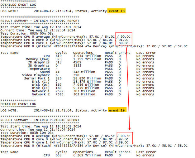

    Hi, We used BurnInTest to test systems, but would like to know some more details about the event log. We have the CPU temp recorded every 10 minutes. The event logs will show current and max CPU temp. (Please refer to "event log.jpg")
    1. Am I right that the max CPU temp is the highest CPU temp recorded starting from the very beginning till when the event log is, rather than the highest temp between 2 event logs?
    2. If so, what's the interval that BurnInTest would record the max CPU temp?
    3. Can we adjust the interval? If yes, how?

    The maximum temperature reported is from the start of a test run (not from when BurnInTest is started and not between 2 interim result reports). The temperature is monitored every x seconds, where x is configured in Preferences->Temp / Battery, "sample every x seconds". The maximum temperature is the highest temperature sample from the start of the test run. The interval where the maximum temperature is measured is not configurable and is always from the start of the test run.
    In saying this, if you needed to measure the maximum temperature for just a specific test period, then you could write a BurnInTest script and have temperature monitoring turned off for the tests you don't want to monitor, and just turn on temperature monitoring for the period of testing you were interested in.

                        Not quite, the CPU max is not monitored. The current CPU temperature is monitored, as mentioned this is configurable in preferences from 1 second upwards. The max CPU temperature is the highest CPU temperature sample from the start of the test to the current reporting time.
                        => Take the event log I posted for example. The current CPU temperature is monitored every 10 mins. The current CPU temperature of CPU 0 core 0 stays 84.0C from event 13 to event 14. However, the max CPU temperature of CPU 0 core 0 went up from 91.0C to 92.0C. That means, BurnInTest still kept track of the max CPU during this interim. Can you tell me how often the max CPU temperature is recorded in the software? (As you said, it's not cofigurable. But what's the default?")

                          The max min and current are all updated at the same time.
                            => The max and current are updated at the same time "in the log file". But BurnInTest should have recorded the max at a more frequent rate. Otherwise, the max CPU at event 14 shouldn't go up from 91.0C to 92.0C but the current CPU stays 84C at both event 13 and 14. Correct?
