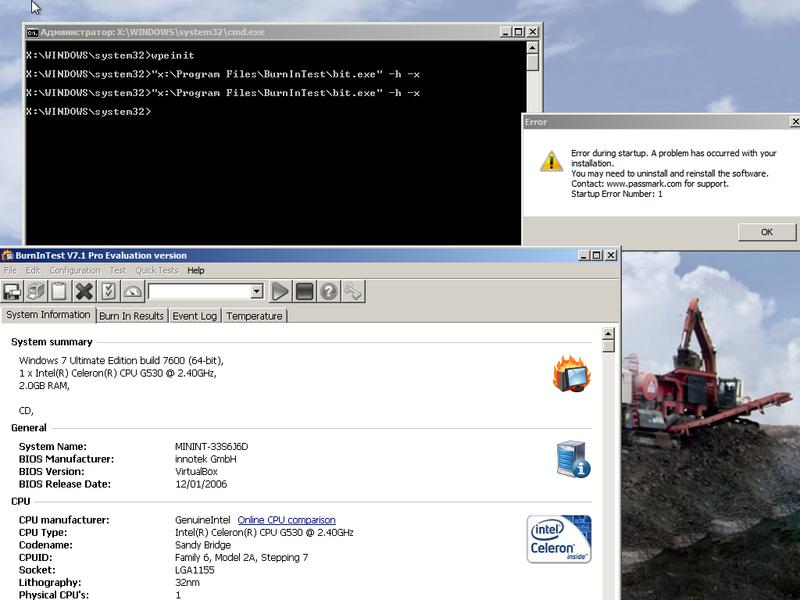

    Hello!
    I'll try to make WindowsPE with BurnInTest 7.1. But I have a mistake:
    Error during startup. A problem has occurred with your installation. You may need to uninstall and reinstall the software.
    Contact: www.passmark.com for support.
    Startup Error Number: 1
    Help me,please, decide this problem.
    Thanks.
    Most likely it is a problem with the license key.
    Did you enter it in during the WinPE creation process?

      Yes, I entered it.

        It looks like the license key information was not found.
        Have you seen our document on creating a WinPE image:
        http://www.passmark.com/ftp/BIT_WinPE.pdf
        In step 5, page 8, you should enter your license key here (File->Install BurnInTest to a USB drive…). This will create a licensed BurnInTest directory that should be put in your WIM.
        If this does not help, please email us: help [at] passmark [dot] com
