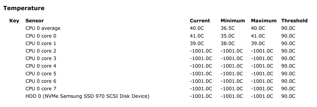

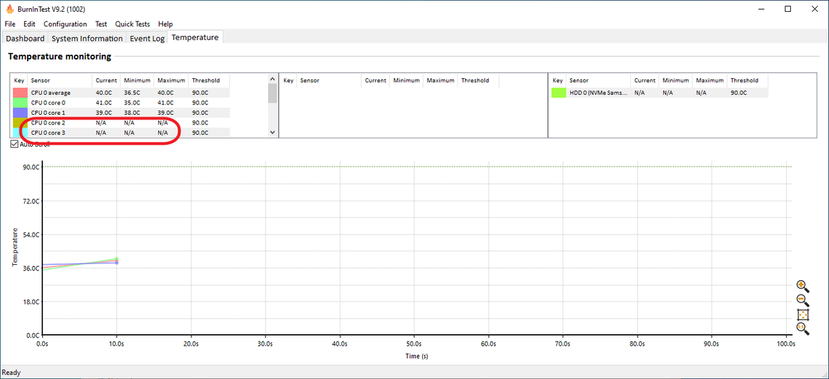

      I have sent you the config file and other info. Here you can see screenshots from the Certificate document, and from the temperature graph. The PC under test has 2 cores, and is running a build that was created on an 8-Core PC.
Name:	BIT old cores in temp graph.png
