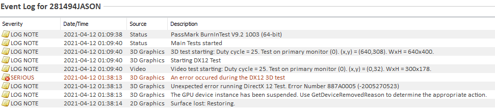

    We are getting the following error across all NVIDIA PCs where 3D DX12 logs a single error, sometimes 2x
Name:	Annotation 2021-04-12 073121.png
    Same error number.

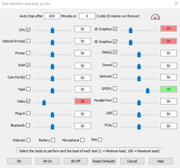

    I've even tried setting the duty cycles lower than we normally would, but we still get the error

    The error code 0x887a0005 is a DirectX erorr and corresponds to DXGI_ERROR_DEVICE_REMOVED, this would normally indicate that the display driver is crashing, which seems to be the case as the 2D test is displaying a similar error with "Surface lost".
    Have you tried downgrading the Nvidia driver to the previous version (assuming it was running without any issues previously)?
    We have seem similar stuff from time to time over the last 10 years. But it is always device driver faults (or device driver faults brought on by low free RAM situations).
