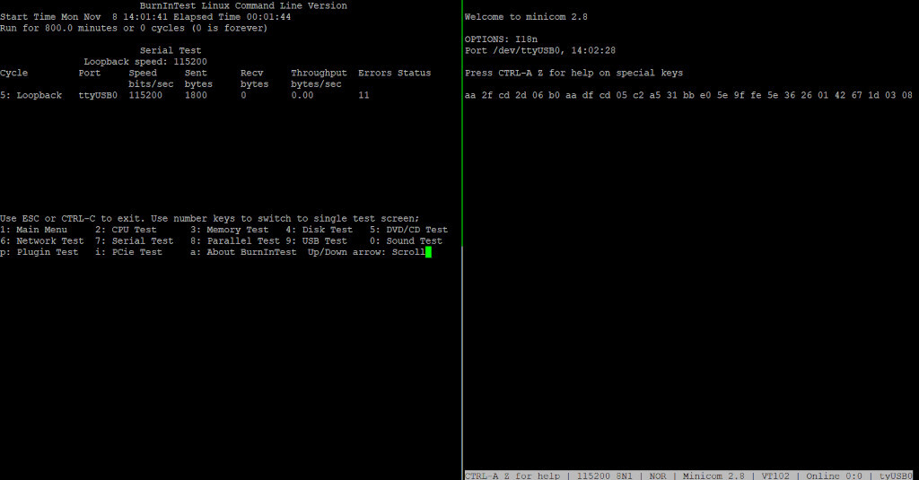

                Same issue using Debian 11 / kernel 5.10.0-9-amd64 ( Debian 5.10.70-1 (2021-09-30) ) / BurnInTest v4.1 (1001).
                Using serial loopback plug, no problem using minicom (with & without Hardware Flow Control), no byte received using BIT (with or without Hardware Flow Control).
                For information, if I open minicom in parallel of BIT, I can see data's (cf. joined).
                BR's
