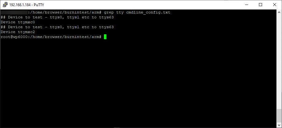

    the resulting log (BiTLog2.log) indicates the ports cannot be found which I believe is caused by the uppercase characters.
    BiTLog2.log
    Any idea how / why the serial port names are being changed and how I can communicate with these serial ports?

    Looks like there's a problem handling some arm devices, this will be fixed in the next update.
    In the meantime you can create a symbolic link to the correct serial port.
    sudo ln -s /dev/ttymxc0 /dev/ttyMXc0
    sudo ln -s /dev/ttymxc2 /dev/ttyMXc2

      Thanks! This worked just fine. Not sure why I didn't think of that!
