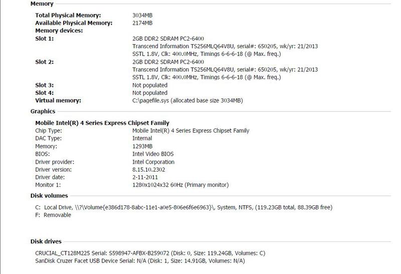

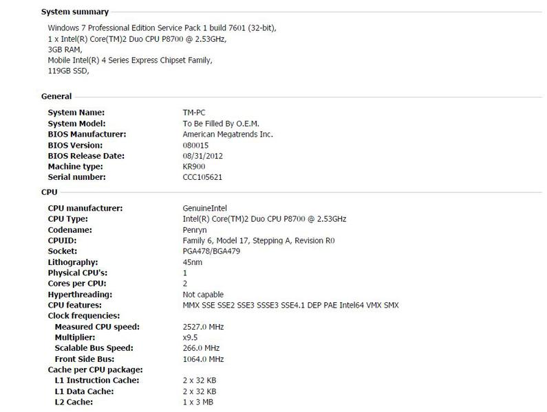

      BurninTest is V8.0 Standard 1031 in trial mode. The system info should be in attached jpg files if I did it correctly. The problem seems to be associated with the 3D capabilities of the graphics adapter. When I run the app on a system with an NVIDIA Geforce GTS 360M it does not report the error.

        -How are you starting BurnInTest? From the screenshots, you are running a 32-bit system. BurnInTest should automatically detect the architecture and be setup to launch the the correct executable. In any case, can you try launching bit32.exe directly from the Program Files directory.
