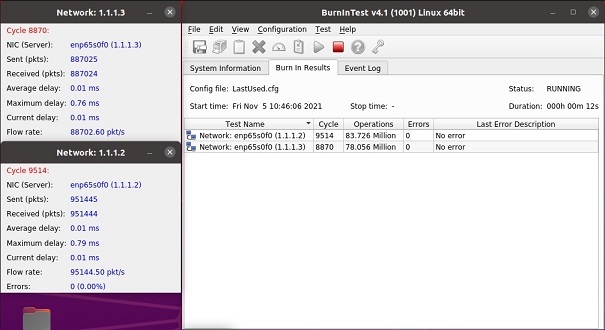

    If not selected "Test all available NICs" , it can be tested but only test network1.
Name:	Screenshot from 2021-11-05 10-46-19.jpg

        So is this a loopback test of two LAN ports on the same system?
        Use IP to identify instead of device ID?
        (Because the device ID are seen to be the same, but in fact the two LAN ports device ID are different)
        Click image for larger version  Name:	Screenshot from 2021-11-05 10-46-19.jpg Views:	0 Size:	50.6 KB ID:	51721​

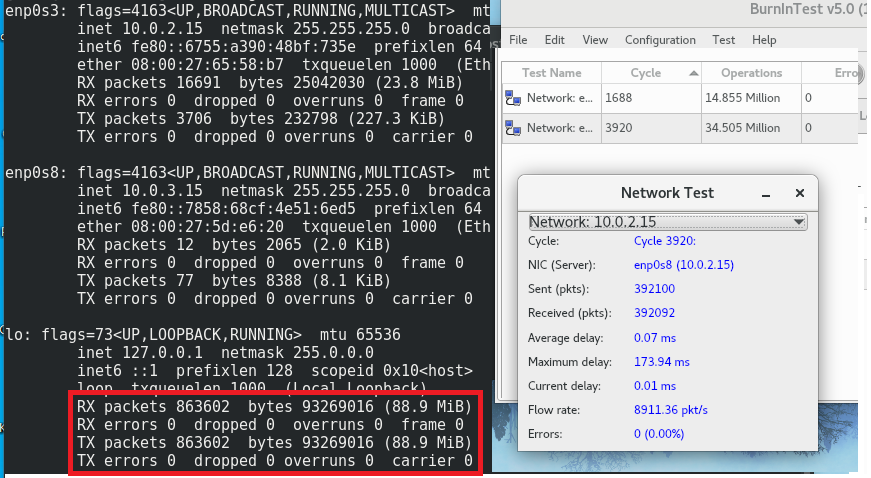

          If those IPs are not external IPs then the traffic isn't really going anywhere (see attached picture, if you watch the network statistics only the local loopback packet count will be changing).
          If you want to test both network cards you should be using an external IP and the "test all NICs" option.
