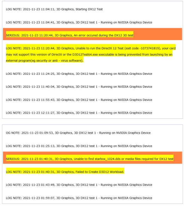

    I get 3D test error log showing An error occurred during the DX12 3D test. Log shows exit code- 1073741819 your card may not support this version of DirectX or the D3D12Test64.exe executable...(refer to attachment screenshot)
    Intel and NV GPU both are duplicate the same problem.

    Exit code -1073741819 is 0xC0000005 (in hex), which is access violation.

    Verify that the media files are present in the installation directory, "<install dir>\Media\SpaceBattle".
    If the issue is easily reproducible, just run the DX12 test and send in the debug log.
