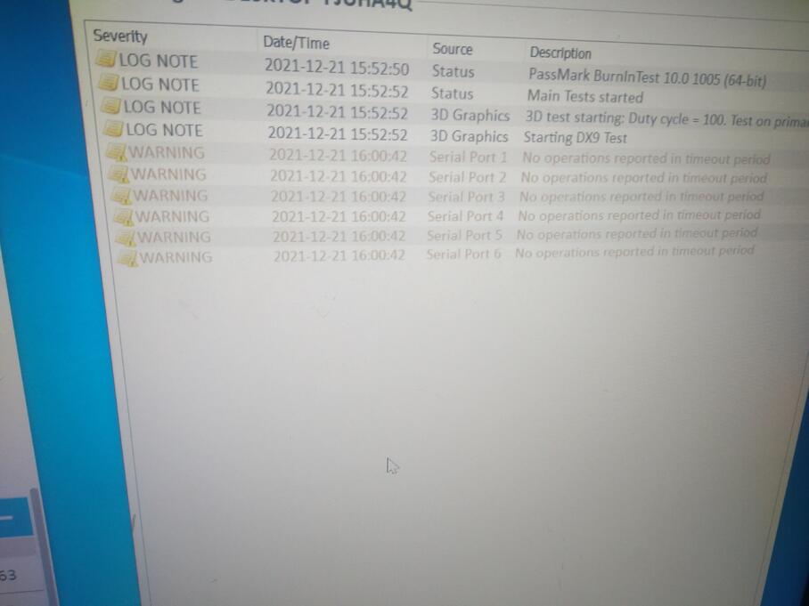

      Port timeout log
        Thanks, I don't see any issues with the memory test in this test run, operations count seems fine so perhaps you are only seeing the error the serial port.
        Can you please include the .trace log as well.
        No operations reported in timeout period for a test might mean the driver crashed (serial driver in the case) or the whole system was super slow. If the system was super slow it might be due excessive load.
        Given this is a new 12th Gen Intel CPU the CPU test may be starting more test threads than the system can handle, especially if you are using 100% duty cycle (BurnInTest may be trying to start up to 32 CPU test threads on this system currently). You can manually limit the amount of CPU test threads running by using the "Select number of threads" options in the CPU test preferences.
        Can you try just the serial port test and see if you still get the errors.

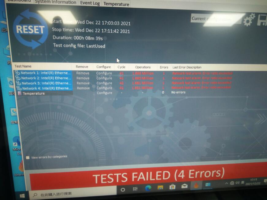

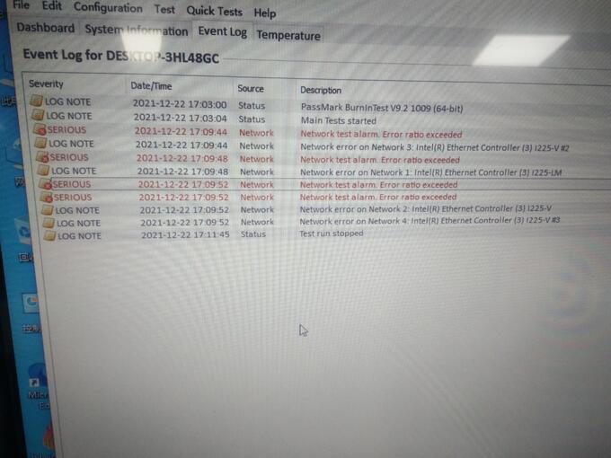

          Manually limit the CPU core. There is no error at present ,Help to see why there are such mistakes in running the network and where it has something to do with it , network test alarm error ratio exceeded
            The standard network test is a simple ping test, the more load the network is under the higher chance it has of dropping packets (they are not considered very important).
            Considering the errors all happened almost the same time on all the network cards perhaps the network was interrupted at that time.

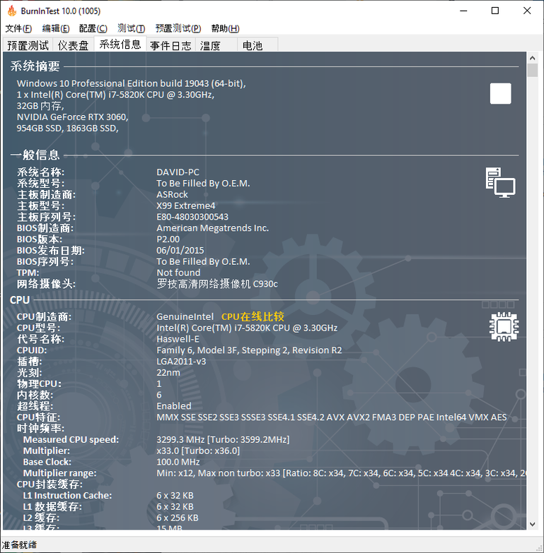

                        You can select the language under the Edit / Settings menu.
                        We have not done a full translation of BurnInTest into Chinese as yet. But there is a lot of the main interface that has been translated / localized.
                        Example below.
                        Click image for larger version  Name:	Chinese-language-BurnInTest.png Views:	0 Size:	427.7 KB ID:	51984

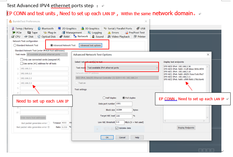

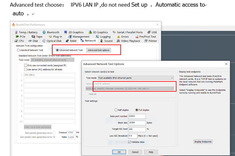

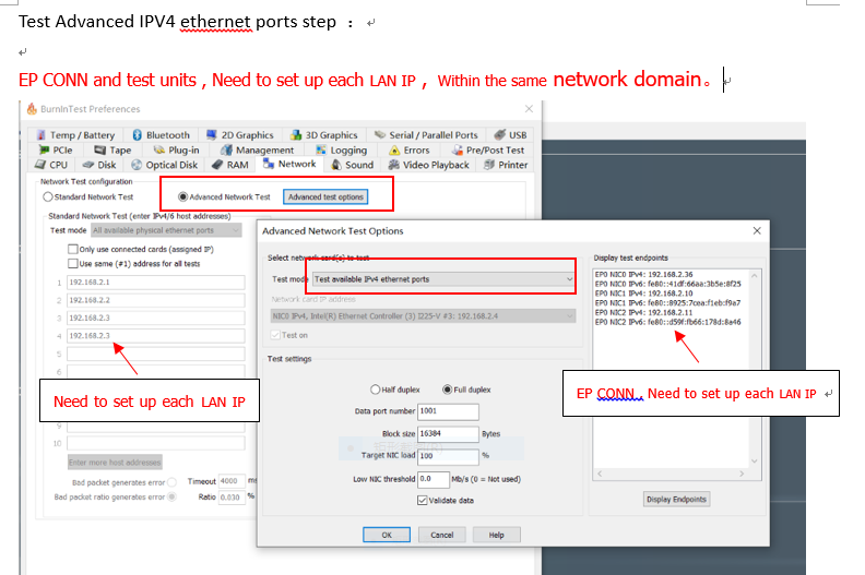

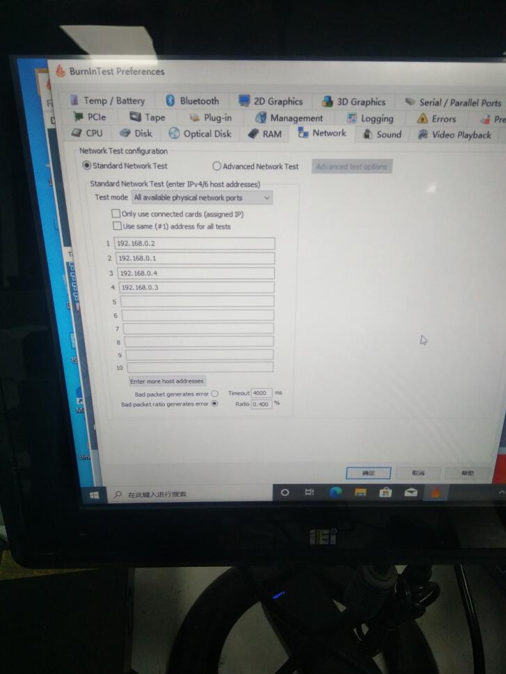

                            Dear David ,Tim:
                            Thank you very much for your answer.
                            I try to test network used advanced test LAN port ,attchment is test data ,I donot know test step if correct ,but test result is pass。 Please help to confirm the testing steps is correct?
                            IPV6 test set as attachment 1~5 pic!
                            IPV4 test set as attachment6~8 pic
                            This test method suitable for all machine?need check CPU platform ,LAN IC FW Etc?
                              There was only 3 image attachments, but your post referenced 8 images.
                              But if the test ran (for a reasonable period of time) and produced no errors, then it should be fine.
