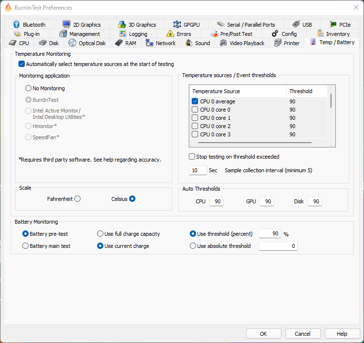

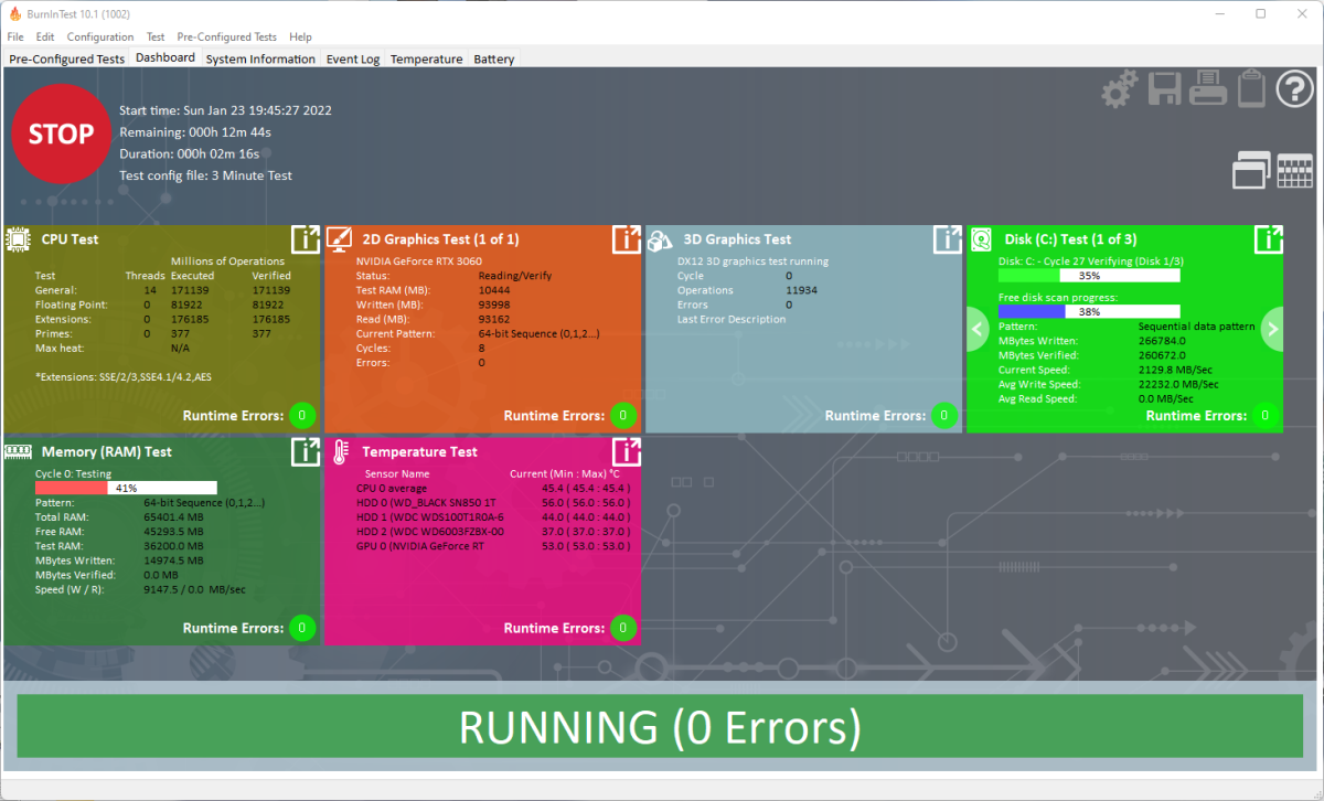

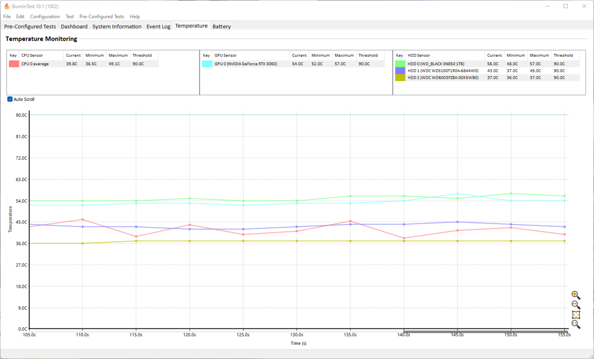

    With BurnIn Test V10.1 (1002) when running the Temperature test in the Dashboard it shows 3 different temps, Current, Minimum and Maximum when the test is running. Problem is they all 3 seem to show the Current Temperature, not Min and Max. Go over to the Temperature Tab and the temps are correct, show different temps for current, min and max. In config for temps have it set to Auto using BurnIn. Have attached 3 screenshots showing problem.
