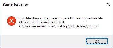

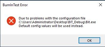

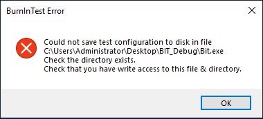

            Upon further testing, I have run into some other issues. I am using the following scripting to start BIT via powershell:
            Start-Process -filepath "C:\Users\Administrator\Desktop\BIT_Debug\bit. exe" -Argumentlist '-P -L 200,100,820,668 -LV -R -S MAINTEST.BITS -X'
            When i run this in my scripting, i get 3 error boxes that pop up (which i have attached to this email). Also, when using the updated build provided the testing will not go past aroud 4 and a half minutes, regardless of how i change the "SET CYCLES and SET DURATION" options. These issues do not occur in BIT 10.1 v1004.
            Any assistance with this would be appreciated!

                The debug version (v1005) that was sent to me opens fine when i just double click on the BIT.exe file. It only throws the error when i try to run bit with either PowerShell or cmd scripting. Interestingly, it does not error out when i put the "-c" argument in specifying a config file (though in the scenario we are running, we do not want to use a config file as the customer wants to visually see in our scripting what tests are being set and what configuration those tests are being set to).
                To reiterate, when this same script is run on the released 10.1 v1004, i do not run into this issue.
                  I didn't seem to have an issue with the script on a test system here.
                  Since you're using the -P command how did you get the BurnInTest files to this directory? Did you do an install to USB and select this location, or copy of from another directory / USB?
                  Given the errors occurring it's likely due to using -P without all the files being in the expected location.

                    I think i figured it out. i added the whole path to the MAINTEST.BITS file i was creating, and the errors went away. This also seems to have fixed the issue with the testing time as well!
