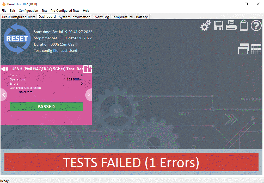

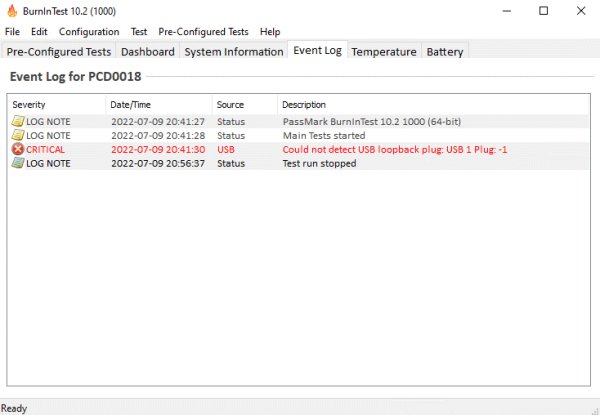

    I don't understand how a test result can be both passed and failed at the same time? Thanks

    It looks like you are testing at least 3 USB ports at the same time.
    USB3 - Passed.
    USB1 - Failed.
    The left / right arrows in the top screen shot allow you to select which USB port is displayed. Or you can maximize the size of the window to view several at once.
    • jsmock
      • Jul 2022
      Thanks, looks like I made multiple mistakes. The test was not configured properly to test the one port with a loopback plug installed, I was thinking I only performed one test, and I forgot about the left and right arrows which should have tipped me off I did not configure the test properly for just one USB port.
