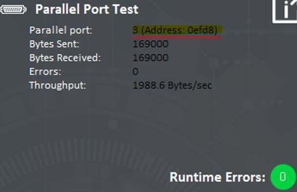

    We are testing a PCIe parallel port card on Window 11 22H2. The card worked well on functionality but error occurred during doing Burin test. From time to time the Burin test is not able to recognize the correct address of parallel card, this leads to errors occurred. There is no error found on Win11 21H2. Does Passmark have any suggestion? Thank you.

    Error Address: Address is 00 so the card is not recognized correctly.

    Correct Address: Address is a non-zero value so the card is not recognized correctly.

    Yes this is a known issue caused by 22H2 breaking driver signing, the debug build here should allow the required device driver to load in 22H2.
      There is a public release available now that should fix the 22H2 driver issues.
