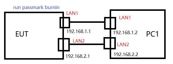

                            According to your suggestion, if you want the network port to have data passing through, it is better to use the test machine to couplet the network port of another machine, right?
                            Is it linked like the picture below?
                            If so, is the IP address of the other party's system network port set in the configuration file (instead of the local one)? I tried to turn on the "TestAllNICs" option and found that after the IP address of the other party was set in the configuration file, the data led of the network port began to blink after the test began.
                            In addition, how much BadPacketRatio is recommended for network testing? For example, is there any basis for setting 2%? thanks

                              Having the network cards directly connected and on separate subnet may complicate things as you will need to have the remote IPs entered in the config file in the right order for Burnintest to use with the cards in the order it sees them (BunInTest won't know to 192.168.1.1 to 192.168.1.2 automatically, it only takes the next IP address in the config file and will bind the next network card to that address), but it should work once you get the order correct.
                              how much BadPacketRatio is recommended for network testing? For example, is there any basis for setting 2%?​
                              There isn't any basis, it's more what you are comfortable accepting as packet loss. With the standard network test using ICMP echo (ping) these packets can suffer from packet loss (particularly at higher rates or with any switch hardware in between that can drop them as unnecessary traffic) so using a ratio % rather than every bad packet generating an error makes more sense.
