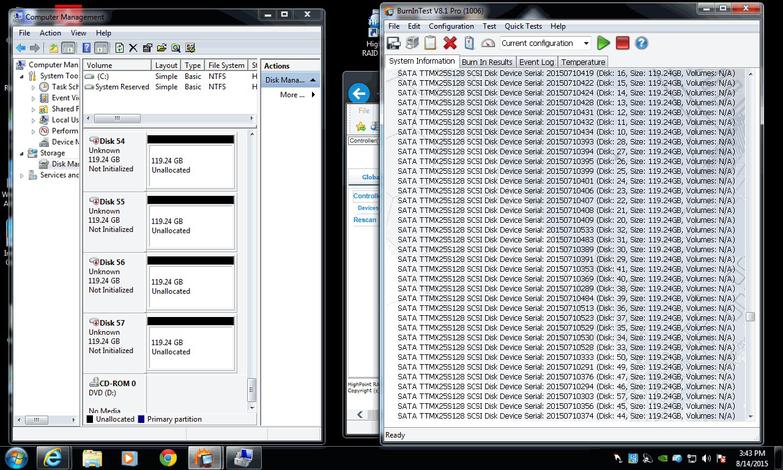

See the attached pics of the first tab shown in both versions, one has the S/N and the other one instead said N/A. One is the "good" BIT version 1008 with the serial numbers but just 50 units. The other set is the "bad" BIT version 1009b that can run more than 50 units but does not show the serial number. I have the debug files that you told me to get but i dont find the way to attach it here... I did attached them to an email sent to help@passmark.com , let me know if you got it. Thanks again for your help.

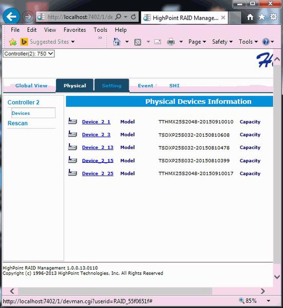

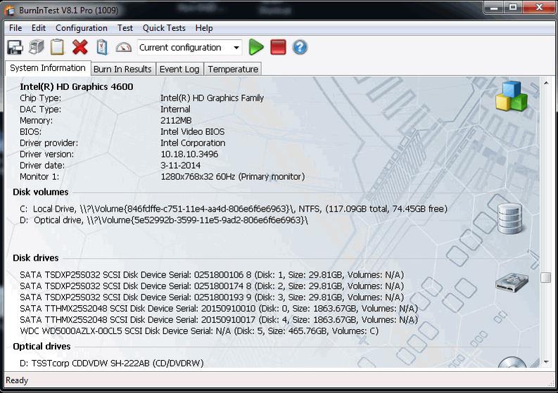

Now, we are always changing back and forth between 2 different kind of drives. Check the attached picsand notice that one line of drives reports properly the serial numbers (TTHM)and the other line(TSDXP) does not. It switched the order of the numbers. Using a couple of different tools, we determine that the actual drives have the right S/N on it, so they should properly show up in BIT. Can you fix this problem? Thanks
This looks like an issue with how the serial numbers are being returned by the WMI system in Windows, as generally when the serial number is returned they are out of order and each byte pair is swapped before display. In this case it looks like 2 of the disk serials are as expected but for some reason the other 3 aren't.

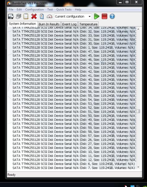

I sent an email with the traces, BTW today i found another minor detail: I pushed more than 60 boards through BIT; it stopped "seeing" the serial numbers after 63 drives were on the system. I also sent to you in the email a capture and the Log for this issue. It is interesting because when you push 78/80 drives, the 15 that it does not see the S/N appeared usually together, but not always. Sometimes i had 8 together and then the rest of it and like that. Thanks
