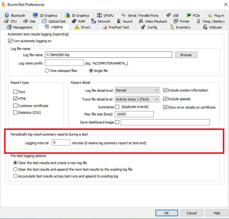

    Hi all,
    I have a strange request from a customer in which they would like to have their systems burned in for 72 hours and provide a result every hour. Is this something that PassMark can do?
    I've had a look at the BurnInTest users guide and the Using BurnInTest in a production line environment PDF and I didn't see reference to whether this is possible or not.
    Thanks​!
    When logging is switched on, by default a result summary report will be logged at the end of a test run. However, you can enable Periodically Loggin if you would like to log interim results summary reports during the test (every X minutes).
