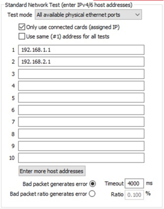

      1. Set up PC IP address as fixed IP address.
      2. Configure BIT network preferences as "standard network test".
      3. Set standard network test host address. Configuration example likes below picture.
      The configuration will be modified depends on real case.
      4. Start test for 5 minutes and check test result.

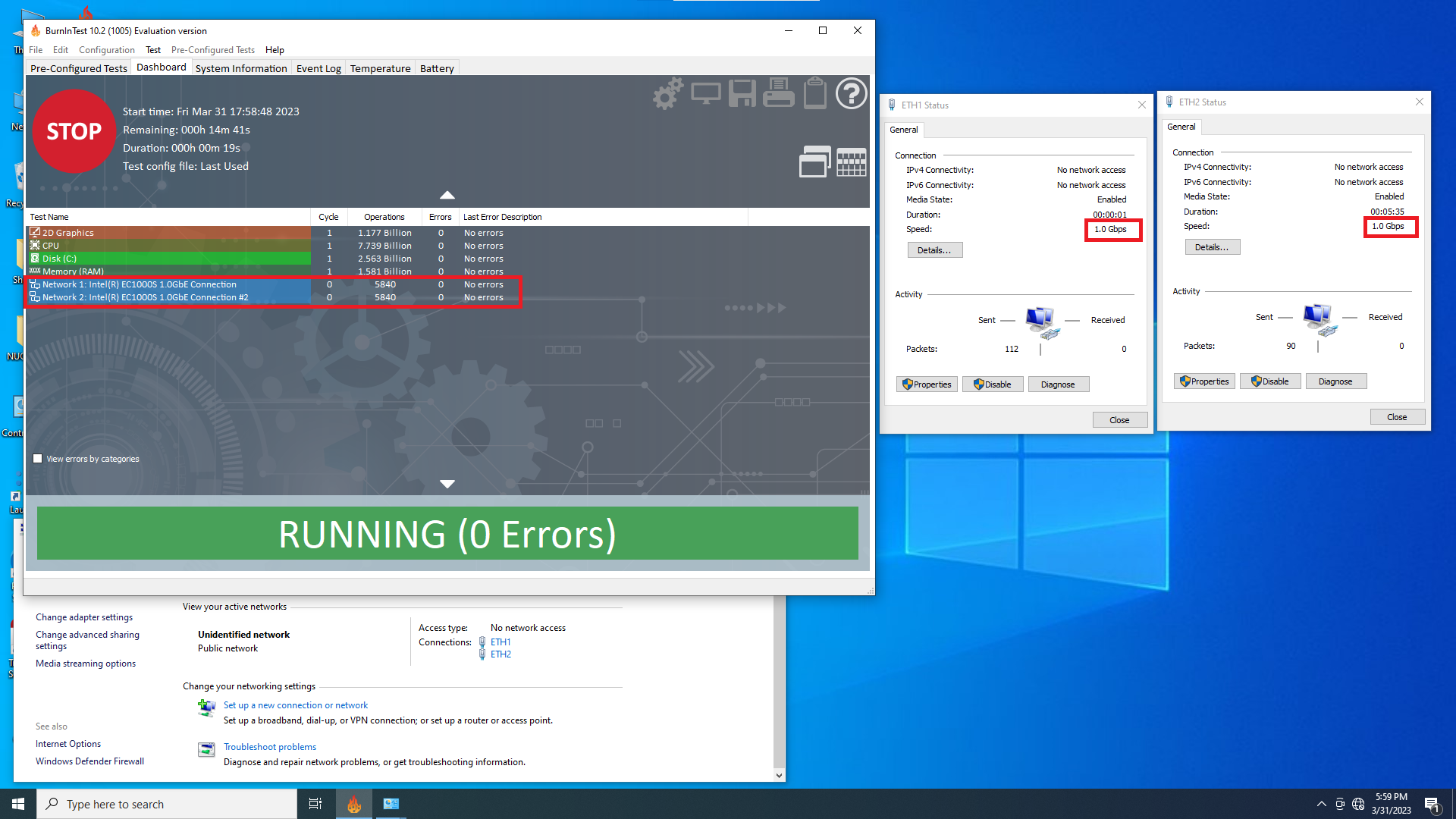

          I have tested V10 and disabled EEE setting on all ethernet adapter.
          I still got the same fail.
          I upload two screen shot.
          First, both LAN port linked as 1Gbps. There is no error.
          But LAN port1 linked as 100mbsp. The issue is occur.
            If the connection is dropped and restarted at a lower speed, then it isn't so surprising that the network connection is interrupted.
