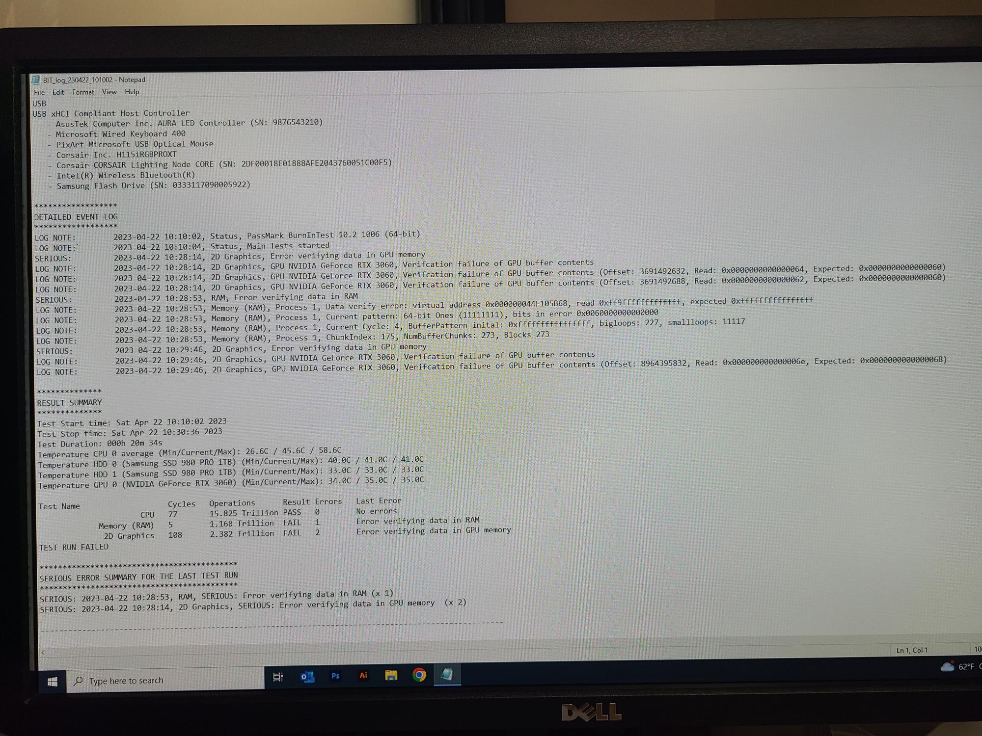

    We are getting RAM and GPU RAM errors that we are starting to believe are not being caused by faulty hardware. We are only testing for 2D video, CPU, and RAM. It seems after starting the test, we get memory pre leak messages in event viewer noting both the memory test and GPU test. Shortly after that, we start to get errors in BIT.
    We have gone through numerous steps, including replacing hardware, reloading OS (Win 10 Pro), and running Memtest86. Memtest comes up clean after 12+ hrs / 4 passes and hardware was replaced with new and we had the same result. I understand that the new hardware that was used as replacements could be faulty as well, but if we run the same tests on build 1004, the system passes the tests.

      Directly after I received the erorrs, I stopped the test and ran v1004 (no hardware changes) and it passed a 12 hour test.
      The log file is of the passed test. I deleted the log file of the failed test, but attached an image of the errors.

        From the screen shot, they do look like real hardware errors.
        Interesting experiment would be to swap back to 1006.
        The 2D video RAM errors reported however might be caused by a failure of main RAM as the data is copied between main RAM and video RAM for the test.
        If you swap the main RAM and test with 1006 does the error stay the same (e.g same byte / buts in errror)?

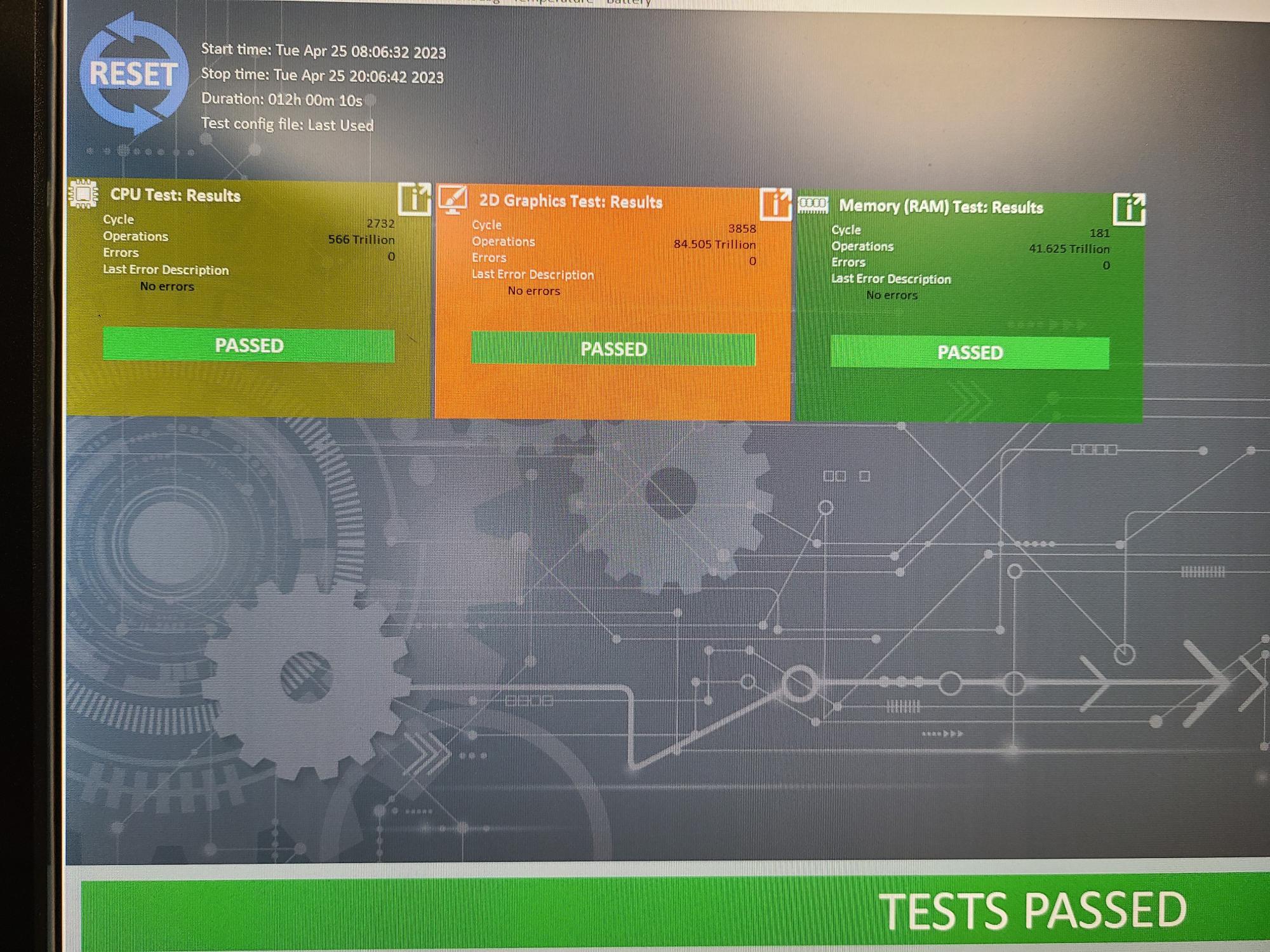

          I tested in debugging mode (1006) last night, same tests (12 hours, RAM, CPU and 2d Video). It passed again with no issues.
          I have made no hardware changes. I can send logs, but I don't know if they help. The only difference here is that I installed BIT locally instead of running from a USB flash drive.
          Now the system has passed both 1004 and 1006 (12 hours) with no hardware or software changes since the failed test.

                  I ran 12 hours of build 1006 last night from the same USB flash drive as before and it passed. I am stumped.
