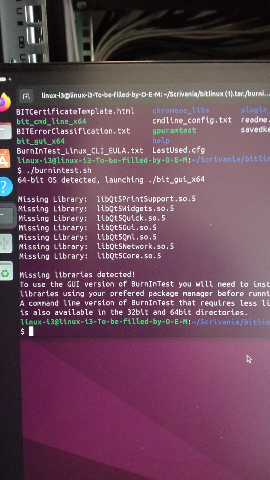

    Hi everyone, I had the bright idea to tell a friend who asked me to help him figure out why his pc was crashing that I know a software that works great (and I confirm it).
    Then I found out that he had Linux UBUNTU 24.04. At that point I downloaded the version for LINUX, tried to change the write/read permissions as stated in the readme.txt file. When I run the software in GUI format it comes up with that message of missing libraries...I tried them all...but I didn't understand...can anyone help me?

    As mentioned when attempting to run BIT Linux GUI, you are missing installed libraries.
    See "Q. Missing libraries in Ubuntu 22.04 with BurnInTest V5"
    https://www.passmark.com/support/bitlinux_faq.php
    Run the below to install missing libraries:
    sudo apt-get install libqt5printsupport5 libqt5quick5

      Wonderful. Function. Many thanks
