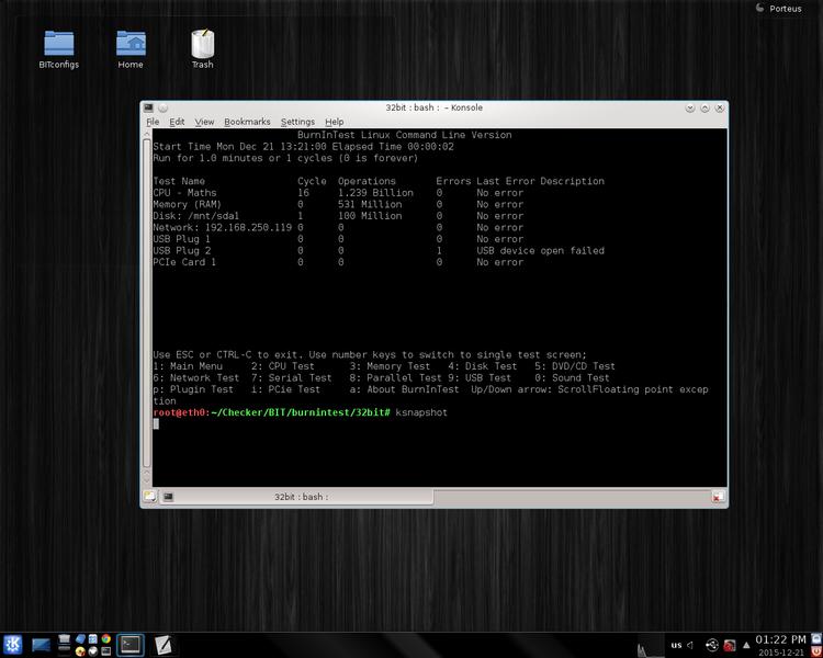

    I am trying to use the command line version of the 32bit burnintest on linux.
    Generally it is working ok, except when I include the PCIe test in the test set. This will result in an immediate Floating Point exception. I have no issues when running the PCIe test in the GUI version or using the scripting (same circumstances).
    Linux version:
    3.17.4-porteus (32-bit)
    Many thanks for your support. Additional info below.
    Kind regards,
    Corné
    Terminal screenshot:

    debug.log:
    Mon Dec 21 13:24:06 2015 - 162257 PCIe get config: 0xFFFFFFFF-FFFFFFFF-FFFFFFFF-C000E (ffffffff ffffffff ffffffff c000e)
    Mon Dec 21 13:24:06 2015 - 162293 PCIe card 1 found [Link Speed: x1 Serial: 0xFFFFFFFF-FFFFFFFF-FFFFFFFF-C000E Firmware: 1.7]
    Mon Dec 21 13:24:06 2015 - 162301 CTest_PCIE::th_test_PCIE card 0 setting clock to high speed
    Success memory locking - mlock success -> Address: 0xa9aff008, Size: 134217728
    Mon Dec 21 13:24:06 2015 - 197946 Success memory locking - mlock success -> Address: 0xa1afe008, Size: 134217728
    Mon Dec 21 13:24:06 2015 - 228794 Success memory locking - mlock success -> Address: 0x99afd008, Size: 134217728
    Mon Dec 21 13:24:06 2015 - 256318 Success memory locking - mlock success -> Address: 0x91afc008, Size: 134217728
    Mon Dec 21 13:24:06 2015 - 296323 Success memory locking - mlock success -> Address: 0x89afb008, Size: 134217728
    Mon Dec 21 13:24:06 2015 - 331989 Success memory locking - mlock success -> Address: 0x81afa008, Size: 134217728
    Mon Dec 21 13:24:06 2015 - 357919 Success memory locking - mlock success -> Address: 0x79af9008, Size: 134217728
    Mon Dec 21 13:24:06 2015 - 374634 Success memory locking - mlock success -> Address: 0x71af8008, Size: 134217728
    Mon Dec 21 13:24:06 2015 - 391494 Success memory locking - mlock success -> Address: 0x69af7008, Size: 134217728
    Mon Dec 21 13:24:06 2015 - 408376 Success memory locking - mlock success -> Address: 0x61af6008, Size: 134217728
    Mon Dec 21 13:24:07 2015 - 162384 CTest_PCIE::RunLoopbackTest start

      I did a small test at the 64-bit Porteus, this gave the same error.
        Could you please try this updated build, http://www.passmark.com/ftp/bitlinux3.3.1002.tar.gz and let us know if you are still seeing the problem.
        • otokonoko
          • Nov 2015
          Hi Tim,
          I have repeated the tests with the build you provided. The problem is fixed. Great!
