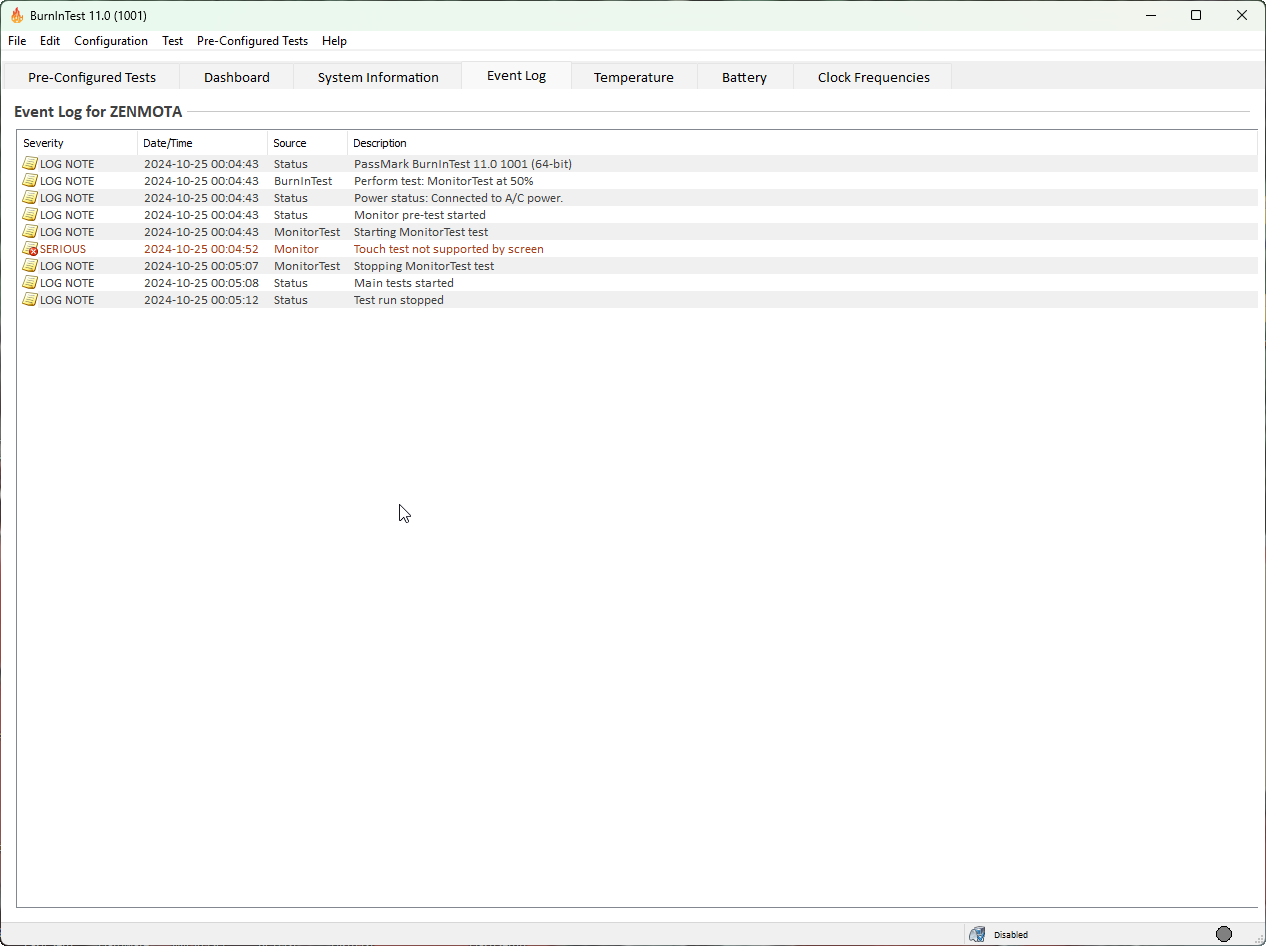

    On the Monitor Test, if I go past the Passmark MonitorTest - Master Screen, it always Fails because it says Touch Test Not Supported By Screen. Is there a way to not test for Touch Screen or does the Monitor Test only work on Touch Screens? Have attached screenshot.
    Yes, it's a bit broken at the moment. Probably usable for non touch screen monitors at the moment. But that was not the intent. It needs to be fixed.
    We are working on it. Likely some improvements will be in a patch next week.

      I guess you meant unusable for non-touch screen monitors not usable for non-touch screen monitors?
        There are a couple of quirky issues. So even for touch screens it isn't working as well as it should.
        It will get patched this week.
          BurnInTest V11.0 Build 1002 was just released. It should improve this issue significantly.
          We may make a few additional improvements for monitor testing soon however.

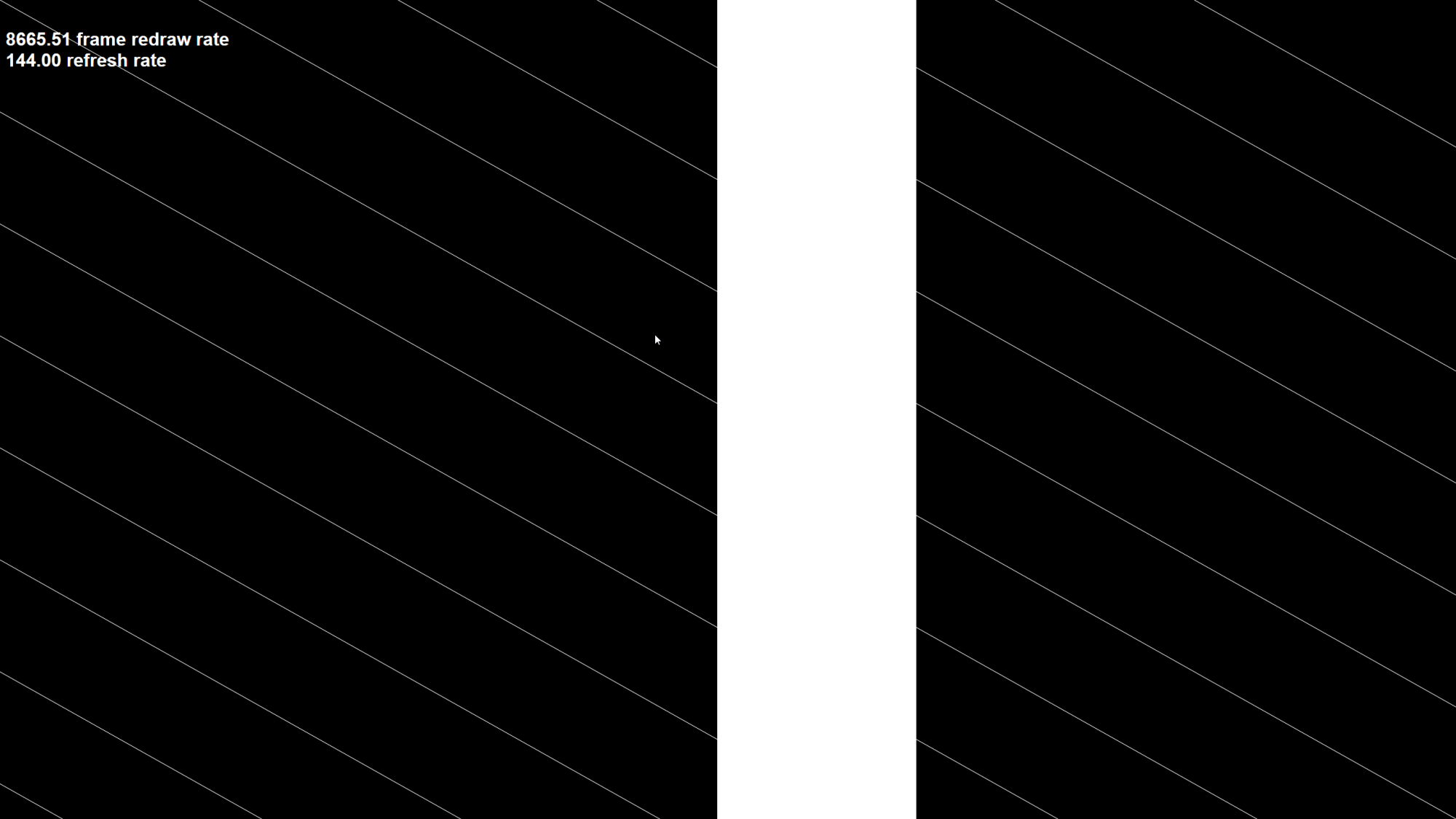

            Yes, it works much better. Doesn't have the touch screen test when you don't have a touch screen. However, there is one screen it comes to that doesn't have place to click forward or backward with mouse. But if I press Esc key it goes on to next screen and passes test Maybe that is how it is supposed to work? Have attached screenshot of screen. Thanks for quick fix to make things better.
              You shouldn't need to hit escape from this Refresh rate test.
              This was fixed this morning & will be in the next patch.
