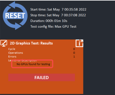

    I am trying to run BurnIn Test on Qualcomm SoC QCS6490 with Microsoft OS Windows 11 but getting issues as mentioned below -

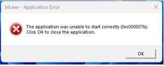

    1. ARM Version of BurnIn Test - Able to install but throwing an error while running as
      bit.exe application error – the application was unable to start correctly
    2. x86 Version of BunIn Test - Able to install and execute but 2D Graphics Test shows an error
      No GPUs found for testing
    Could you please help with these issues?
    Appreciate your inputs.

    Attaching the BurnIn Test Errors with ARM and x86 Versions
      For this SoC QCS6490 system are you running 32bit or 64bit windows?
      The error you got, "the application was unable to start correctly 0xc00007b", might mean you are trying to run our 64bit code on your 32bit operating system.
      The the other problem with no GPUs when running x86 emulation, I assume this is because the x86 to ARM emulation is incomplete and doesn't include DirectX support on this system?
      Note: We don't think it makes sense to ever use 32bit Windows anymore. Even on very low end systems.

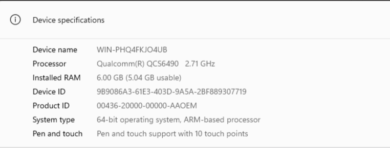

        We are using 64Bit Windows and the SoC is also 64 Bit ARM ARCH.
        We are not at all using 32 Bit Windows.
        Please find attached OS and System configurations.
        Regards,
        -Vijay
          Is this a full version of Windows 11.
          Of maybe Windows for IoT / Embedded?

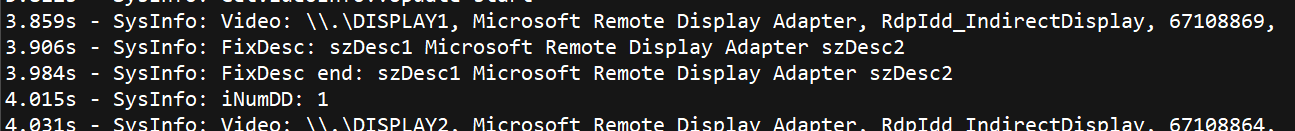

                  I captured the logs by passing "-u" application.
                  Please find attached logs.
                  Regards,
                  -Vijay
                    The iteration of the display devices on this machine didn't find any video card / display that could do DirectX.
                    Instead a driver called "Microsoft Remote Display Adapter" was loaded.
                    This was the log
                    I think this Remote Display Adapter is used when you don't have a monitor connected via a normal HDMI cable and instead have some type of wireless connection to a remote monitor?

                      I have the External Display Over HDMI connected, I ran the test again(BurnIn Test Version).
                      Here is the attached Logs, Trace files.
                      LOG NOTE: 2024-12-17 11:03:03, Status, Main tests started
                      LOG NOTE: 2024-12-17 11:03:04, 2D Graphics, Starting 2D Graphics test
                      LOG NOTE: 2024-12-17 11:03:04, 2D Graphics, Start 2D GPU Memory test
                      LOG NOTE: 2024-12-17 11:03:04, 2D Graphics, GetNumberCLGPUs - clGetPlatformIDs failed [-1001].
                      SERIOUS: 2024-12-17 11:03:04, 2D Graphics, No GPUs found for testing​
                      I think the app does not have support for the Qualcomm SoC - QCS6490 GPU.
                      Could you please check?
                      Does the 2D Graphics Test uses DirectX or OpenCL APIs?
                      Regards,
                      -Vijay
