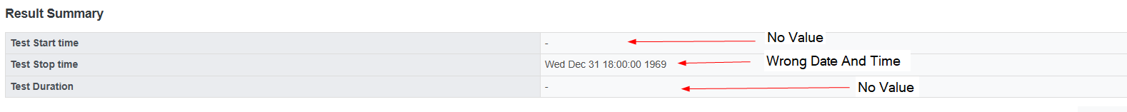

    I noticed that if you create a Report under Result Summary the Test Start Time and Test Duration​ are blank. However, Test Stop Time does have a date and time. But it is not the right date and time. Have attached screenshot.

    OK, it looks like you have Save/Create report before you click the Reset after test. If i create Report before clicking Reset the Test Start Time and Test Duration values are there and the Dates and Times are correct.
