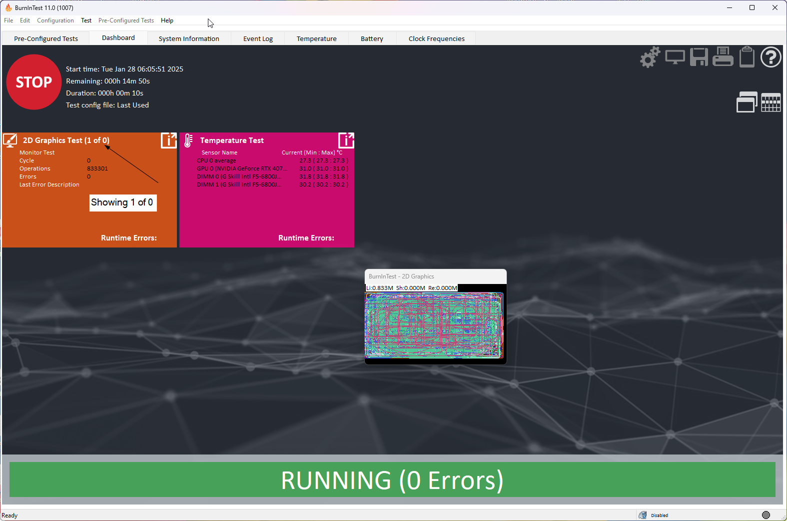

    BurnIn Test 11 Build 1007 2D Test
    The 2D Test-Monitor Test is still showing 1 of 0. This happens if you first select Monitor Test - Test This Monitor and run it (shows 1 of 0). If you go back and select Local Video Memory (GPU, RAM) and run the 2d Test it shows 1 of 1. Stop that test then go back and select Monitor Test - Test This Monitor run the test, it now shows 1 of 1. You must select Local Video Memory first and run that test and then go back and select 2D Monitor Test - Test This Monitor and it will show 1 of 1 instead of 1 of 0. Have attached screenshot.

      Looks like we accidently reverted the change showing '1 of 0' in another commit.
