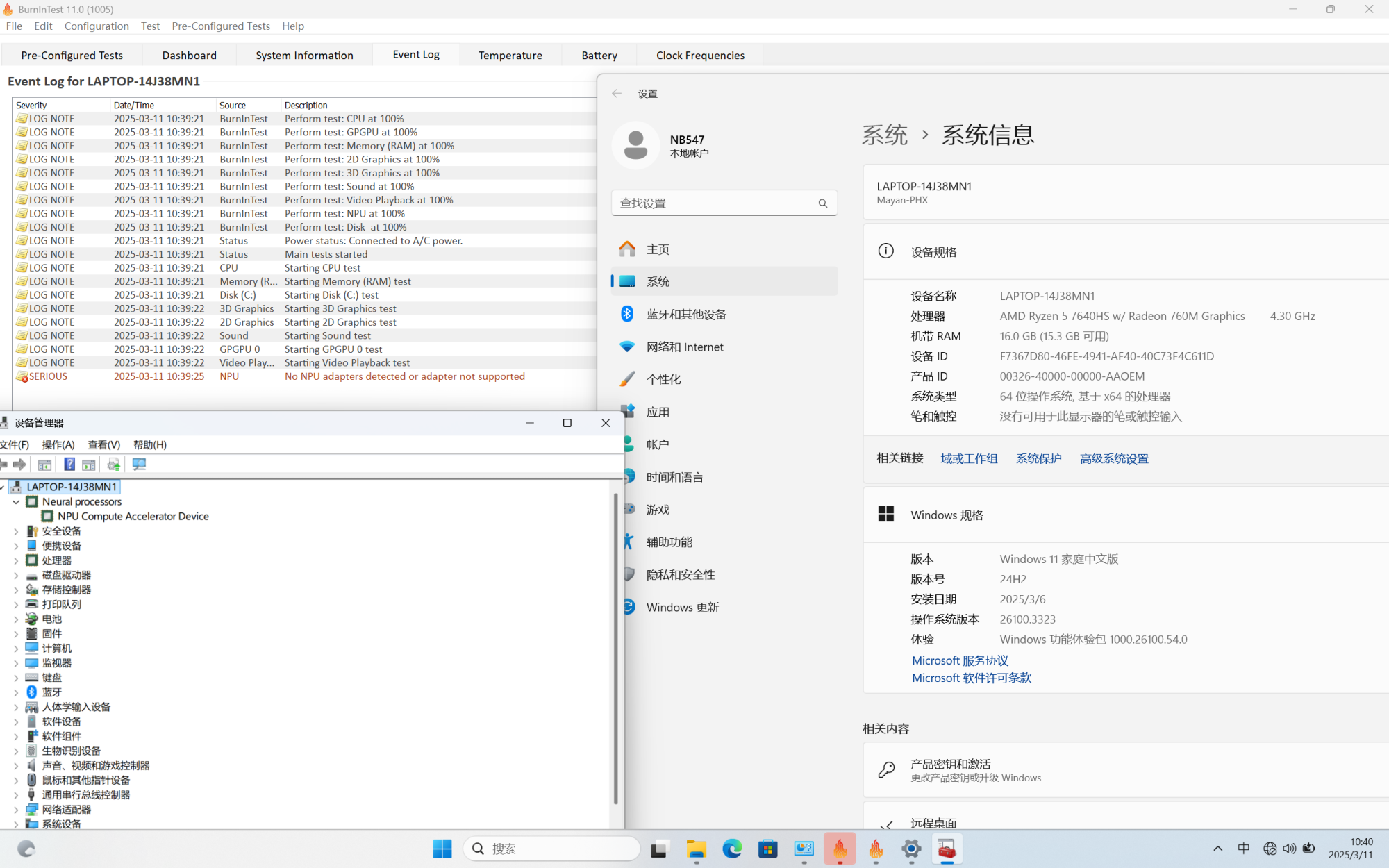

    When we test NPU with BIT 11.0, There will show error message No NPU adapters detected or adapter not supported.
    DUT config:
    AMD 7640HS
    OS 24H2
    Please help to confirm if BIT NPU test support 7640, Thanks.
    These models didn't really have a functional NPU (despite the marketing).

      So you mean NPU test is not support on 7640 and 7840?

        And if there is any support plan for these APUs. Thanks.
          From our investigations it is impossible write code that uses this early AMD NPU hardware in any sensible way.
          AMD never provided the documentation nor examples. So basically the hardware is useless (unusable) as far as we know.
