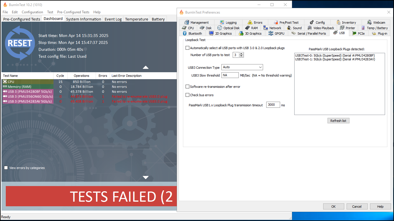

                  Click image for larger version  Name:	image.png Views:	0 Size:	186.2 KB ID:	58939 ​

                      ​David (PassMark),
                      Thanks for your information.
                      We do have an USB2.0 device on the other downstream port.
                      However after disconnecting that USB2.0 device, the issue is still existed.
                      I found another post which discussed a similar issue.
                      It mentioned a timeout setting of USB test which could avoid this re-enumerate error.
                      I can only find below similar setting.
                      Is it the same setting for USB3.0 loopback plugs?
                        Enumeration is a low level process, that occurs without any interaction at the application level. (i.e. it is at the level of electrical signalling and integrated circuits).
                        That timeout you mentioned was not for enumeration step, it was for how long the application level waits for data to be fully transmitted.
                        If you really want to get to the bottom of it you are probably going to need a protocol analyzer.
