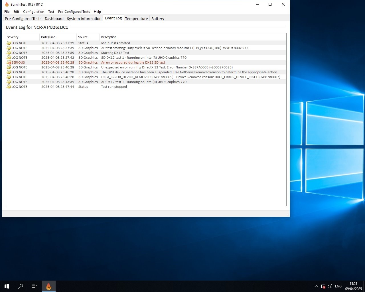

    I have an error after running Burin-in Test (V10). The error report says 'An error occurred during the DX12 3D test'. Can you tell me what triggers this message to appear? In order to debug this further. Attached shows my config settings, most are 50%.
    I have confirmed there are no issues with DX9 setting.
    Can you point me in the right direction for debugging this further?

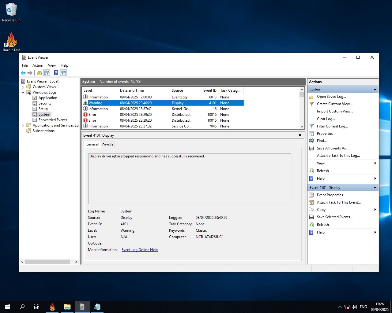

          I found entries in the Event Log page. 3D error occurred at 2025-04-08 23:40:28.
          I can see in the Windows System event logs, at 23:40 'Display driver igfxn stopped responding and has successfully recovered.'

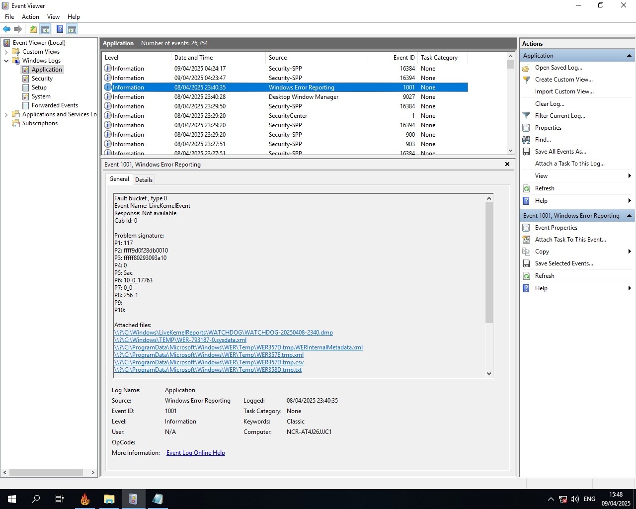

          Also in the Windows Application event logs there is an entry for 23:40 from source 'Windows Error Reporting'. I'm not sure exactly what this is telling me. Can you tell from the event log entries what has caused the 3D error?
          I have x2 separate PC Cores that have a similar entry in the Windows logs. Same graphics driver and OS image on both. I can see an error after 24 hours test.

            Hi David,
            Sending Windows Applications log error info for error at 23:40
                Video cards use a piece of software called a device driver. It standardizes the interface to the video card hardware. So for example, a game only needs to be coded once and works with all video cards (this didn't use to be the case 35 years ago). The standard interface implemented by the device driver is DirectX. The current version of BurnInTest uses DirectX12 by default, but there is an option for DirectX 9.
                Ever since video card device drivers were first implemented, they have been buggy. Arguably the most buggy piece of software ever created (but browsers would come close).
                nVidia for example is up to version 572.82 of their driver. So more than 500 releases, without even counting minor releases. But even after so many releases it is possible to make videos about all the bugs.
                So drivers are hard to get right, and hard to debug.
                Anyway, that error in your log means the Intel driver, igfxn, disappeared, crashed or froze up.
                Once the driver is gone, DirectX starts reporting errors to BurnInTest and we report them to you.
