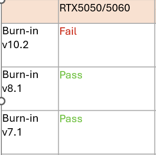

    Dear SIRS:
    We Got GN22 (RTX 5050/5060 ) fail on Burin 10.2 , fail item are 3D/2D /GPGPU Test on NV GN22 GPU.
    system config: RPL I7-13620H/ DDR4 Memory /GN22 (RTX 5050/5060 ) ,
    and we change back to old version V7.1 and V8.1 are Pass on same system ,
    do you know the diference betwen V10.2 and V8.1 ?
    please kindly provide comment or suggestion for use ,tks.

    V10 and V11 of BurnInTest have a much more complex 3D (DirectX 12) test compared to earlier versions.
    So it makes more use of the DirectX API and places higher load on the video card.
    We've had a collection of different recent errors with the 5xxx series video cards. The situation is documented here.
    https://forums.passmark.com/burninte...force-rtx-5050
    (Some of these cards seem to have real problems).
