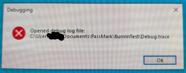

        When Burnin is started in debug mode (-u), the following query appears:

        I have to click away this message twice before Burnin starts. Unfortunately, this message also appears when it is started with a script (automatically). This means that I have to click away this message manually after every reboot. I assume that it is not possible to bypass this message.​
            Currently, cannot be bypassed. The message is displayed to show the user where the debug logs are saved to so the user can send them to us. Debug mode is typically only used to for debugging and not in normal testing, so not normally an issue in production.
