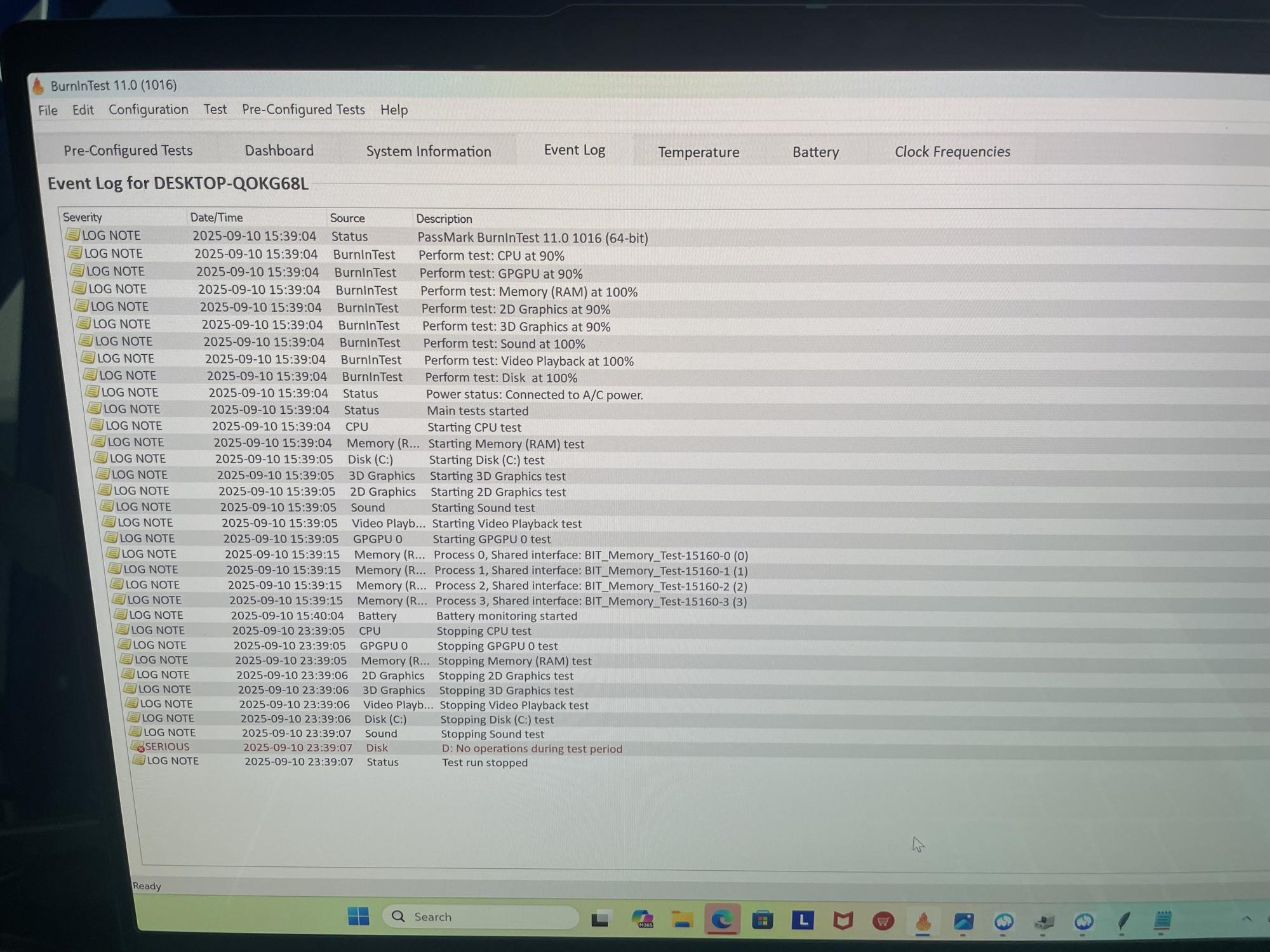

    Burnin V11.2(1016) show disk2 error
    Please help to check dose this is a knowe issue or not.
    Dut to it can get pass result if use Burnin V10.2

    Can you check if the Battery Life Testing checkbox is enabled? If so, can you disable this setting in BIT Preferences > Battery tab. Issue with that setting where it will only test the first disk - will be fixed in the next build

      Hi Richare,
      Thank you for your feedback.
      I have tried to diable the Disk and can get pass result.
      And I see the B/I ver V11.2(build 1017) also can get pass result without disable Disk.
