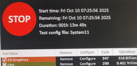

    2. After execution of BurnInTest the "Remaining:" time always reflects the "Start time:".

      I will attach a snippet from a quick snapshot taken last week that illustrates the issue with "Remaining" always equals "Start time".

          Thanks for letting us know & screenshot - 2nd issue will be fixed in the next build
