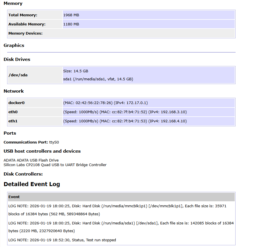

    After running the Passmark test on two network interfaces and two disks for a period of time, the program would automatically exit and an error message like the one shown in the figure would appear regarding Ethernet. For instance, I set the program to run for 12 hours, but actually it automatically stopped the test within less than an hour.
    My product has only 2GB of memory. After the system boots up, the remaining memory is approximately 1.4GB.

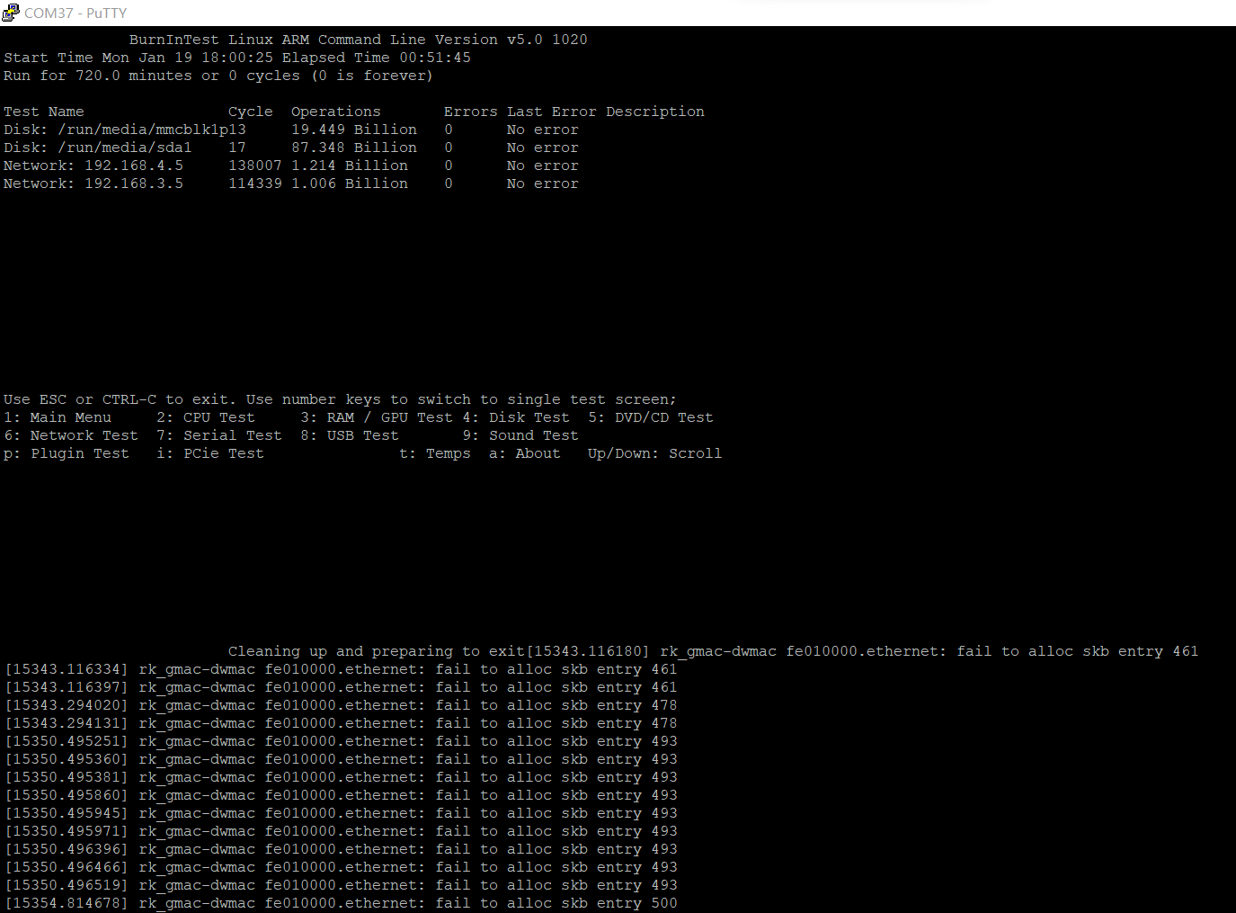

    For the detailed test log, please refer to the attachment. This is the result of the last test.
      The error, ethernet failed to alloc skb entry, occurs when the system is low on RAM.
      SKB is the socket buffer, they are central data structure representing a network packet, acting as a container that holds the actual packet data (payload and headers).
      So no buffers available means no network.
      So then the question is why is there no free memory. Is it becuase
      A) There is no swap file setup, but should be.
      B) You are just running too much on this machine (compared to the very limited hardware capabilities)
      C) There is a resource leak. So over time free RAM decreases when under load. Eventually leading to a guaranteed crash.
      2GB with a light version of Linux should be enough to run BurnInTest.
