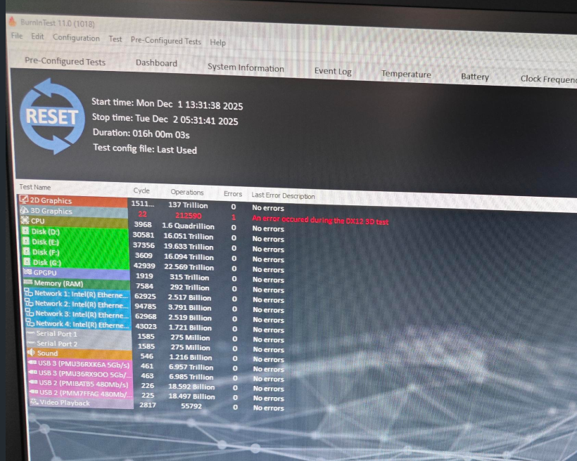

    2、The second question is that when we test DX12 with the newest BIT V11 and BIT V10,an error occus.But when we test DX9 with BIT V10 ,it can pass.The solution we can also accept.I'd like to ask you to help provide some professional analysis.Thanks for your help
    By the way, this issue occurs in projects equipped with DDR5:
    DETAILED EVENT LOG
    INFORMATION: 2025-12-01 11:15:12, Disk, D: Butterfly seeking skipped for this disk (SSD/NVMe)
    INFORMATION: 2025-12-01 11:17:17, Disk, E: Butterfly seeking skipped for this disk (SSD/NVMe)
    INFORMATION: 2025-12-01 11:25:42, Disk, G: Butterfly seeking skipped for this disk (SSD/NVMe)
    INFORMATION: 2025-12-01 11:32:52, Disk, D: Butterfly seeking skipped for this disk (SSD/NVMe)
    SERIOUS: 2025-12-01 11:33:55, 3D Graphics, An error occured during the DX12 3D test
    LOG NOTE: 2025-12-01 11:33:55, 3D Graphics, Unable to run the DirectX 12 Test (exit code 0xC0000409), your card may not support this version of DirectX or the D3D12Test64.exe executable is being prevented from launching by an external program(eg security or anti - virus software).
    Video card device drivers crashing under high load or low RAM conditions is fairly common. Plus there are a lot of old (and even new) video drivers with bugs.
    The DX12 test is a lot higher load than the older DX9 test.
