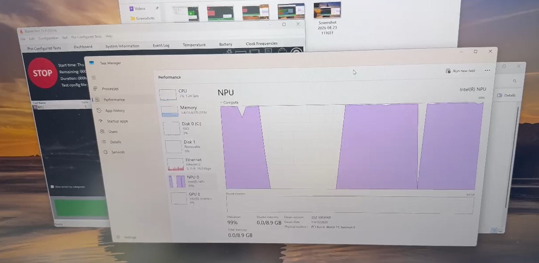

    When verifying the NPU using Burnintest 11 (1024) at Panther Lake UH, the loading rate is not always at 100% and sometimes drops to 0%.
    OS:Windows 11 24H2
    CPU Intel Ultra 5 338H
    NPU Driver verison 32.0.100.4509

              Hi David, I was verifying NPU functionality. With Loading set to 100%, I checked the NPU usage through Windows Task Manager and found it dropped from 100% to 0%. Is this normal?
                • 11114
                Brief drops are normal as there is a setup time required to program / setup the NPU, and task manager doesn't seem to record this as "load".
