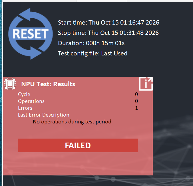

Start NPU test without error message, after 15 min test, result will failed and operation is 0.
Please refer to attached log and fail screenshot.
If NPU test of Burnin support Gorgon Halo currently? Cause AMD NPU test tool and Procyon can run normally.
Please help to check this, thanks a lot!
